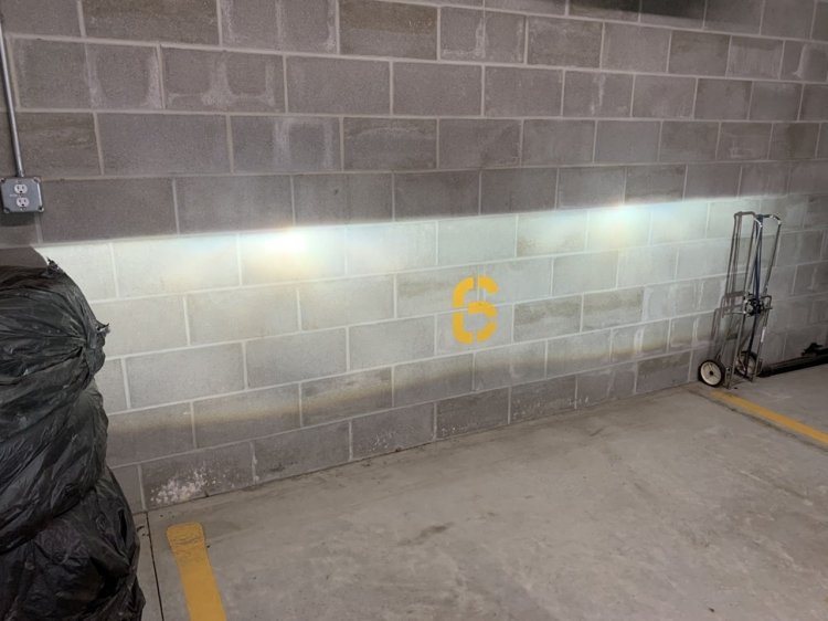

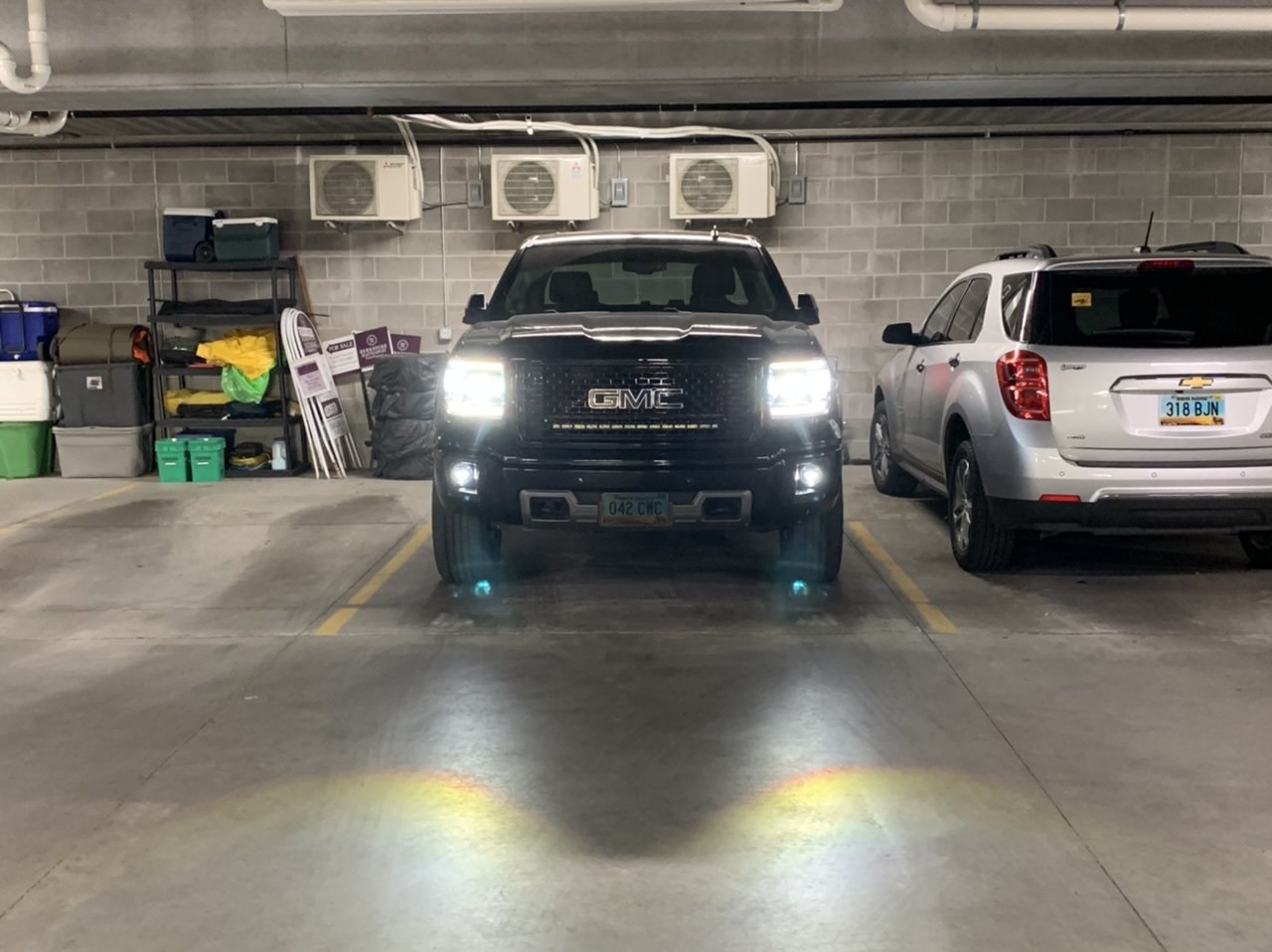

I have the Hylux 45w kit with Morimoto bulbs (from TRS) in the OEM projectors. Wish I would have retrofitted the 3" FX-R projectors while I had the headlights opened to clear them, but I am happy with the results.
Did you have to get error cancellers? I have a 2014 SLT AT and I'm wondering if I will need error cancellers if I go with this set up.
Thanks!
Thanks!
I believe so, if you don't, the automatic headlights won't work correctly from what I've read. I've never tried my setup without the capacitor link though.. For $20 I would get them just to be safe but it would be interesting to see how they would act without it. My thought would be flickering upon start up due to the incorrect voltage to the ballasts...
Thank you! You only need one right? Since the relay harness connects to one of the original bulb pigtails only, from what I gathered.
Correct. I wired mine on the passenger side since I already had a good grounding location for the relay harness itself.
