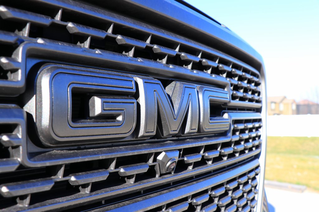

I think your best bet is going to be finding a color that compliments the pacific blue well, finding something in vinyl that's going to match not just the color, but the metallic flake and the gloss is probably going to be nearly impossible. I was in the same boat as you, 2020 pacific blue. looked online at all the GMC accessories in several colors for direct swap out parts, but not in this color. I ended up buying new mirror caps and door handles and having a body shop paint them body color for me. I paid way more than I would have if GMC would sell the parts in this color ready to go. but I hate chrome that much it was worth it to me. one advantage of going this way, even with factory painted door handles the little lock/unlock button is always chrome...mine is pacific blue ?
I used a metallic gunmetal plastidip treatment on the front end of my truck, grill, fog surrounds, and the lower insert. I took the recovery hooks off and left them off. I'm not sure if this is my final design but its great for now. I actually want at least the grill surround to be body color eventually, but I'm not sure if it would really look right with everything body color up front. I will need to gimp it and how it looks.

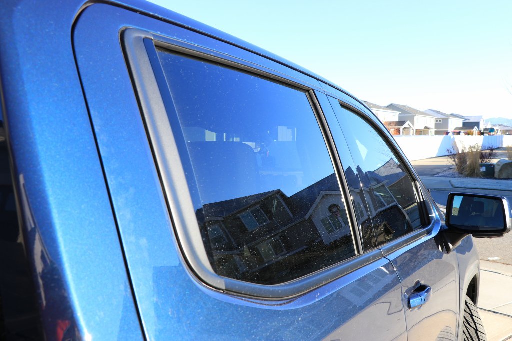

I did vinyl wrap on the chrome window surround and deleted all of the factory badges (except for the GMC up front, which I plastidipped over, so its still there, you can see it, but it doesn't scream at you anymore. I also did vinyl wrap on the engine badge with a custom insert, but later redid that in the same plastidip so it matches the front. New wheels and matching lug nuts and the only chrome left on the exterior of my truck at all are the exhaust tips, which are going to go as soon as I get the extender piece from Borla then my dechromed Borla tips go on.

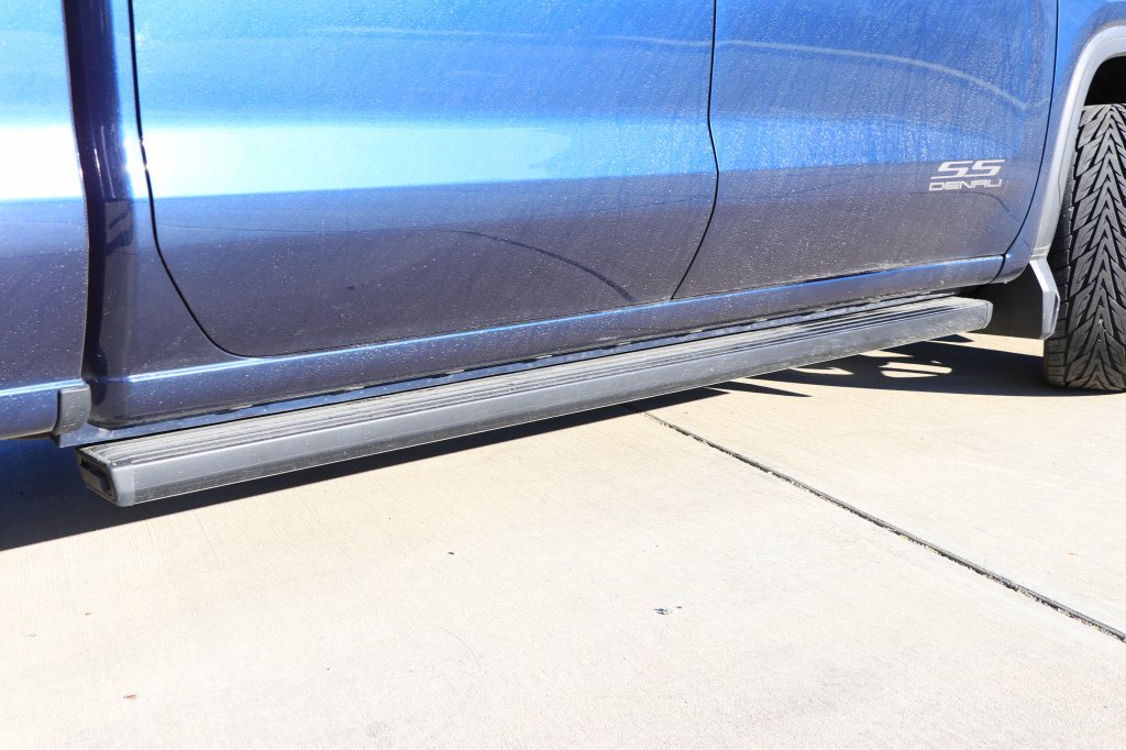

ok, as long as you don't mind it being so dirty...rain!
I like the look, I wish I had gone a little lighter on the wheels and plastidip. they do match pretty well though, the wheels are powder coated. The red Brembo brakes will make the wheels look better also, one was damaged during installation so I'm waiting to get it back.

Looks good. Does the plasti dip hold up well with car washes?
It has so far. I've washed it a few times. I haven't used any automatic washes though nor have I used a pressure washer on it. supposedly it can even survive pressure washers as long as the pressure isn't too high.
I also saw this one tip online that turtle wax ice spray wax works well on plastidip and helps to protect it. Who knows, but I tried it anyway. so far no problems.
doing the grill was the hardest part. you don't want that stuff all over your radiator. there isn't much room but I removed the plastic trim piece above the radiator under the hood and was able to work a cover cloth in behind the grill and in front of the shutters. there's lots of room between the shutters and the radiator, but I didn't want the coating on the shutters either. so that took some time to properly mask everything. but after that the process went pretty smoothly. I did a total of about 7 coats of black and 2 of gunmetal metalizer on top of that.

Can I ask... why the SS logos?
To honor my last truck. Miss it! Wish i could have kept both. Projects are allowed to have codenames, Denali SS, i like the sound of that. much of what i am working on for mods is to get it set up as much like my old ss as i can.  picked fhe same color, getting rid of the chrome etc. So thats what i decided to call it.
