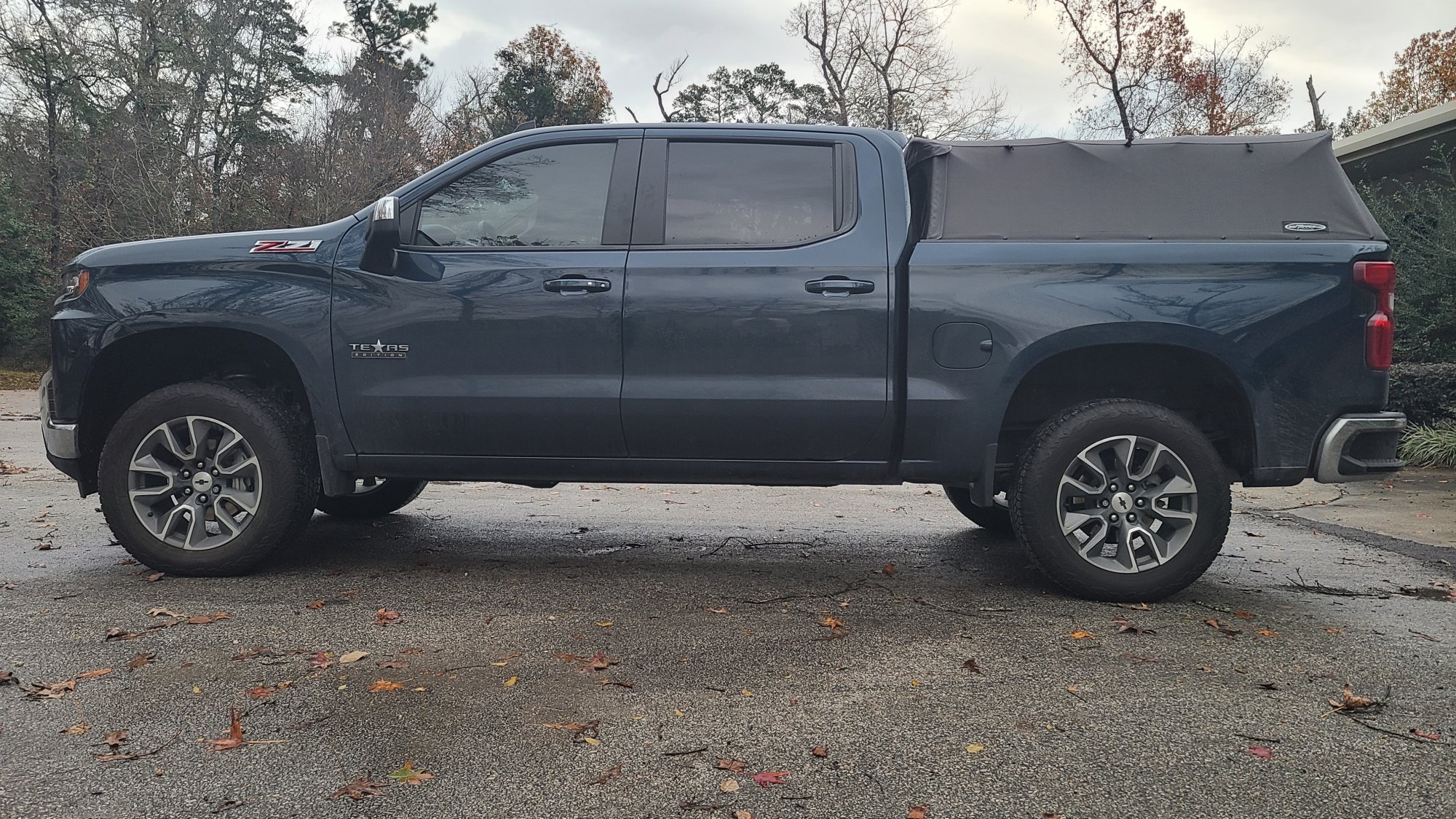

I posted troubles with my Eibach install around 7 or 8 months back and shelved the suspension components until I felt like fooling with them again.  Well, here we are 8 months later (approximately 20K miles) and my stock ranchos were done and starting to clunk over bumps.  I put aside some hours this past weekend, dove back into the install, and completed the front spring/shock install as well as the rear shock/block install.  The front took about 6+ hours total since I took my time and double/triple checked everything as I was doing it.  The rear took about 2 hours and would have taken significantly less if I wasn't so ****** about everything.  All said and done, it was about an  8-9 hour job, but could be done in 4-5 if you were motivated to do so and had done it before.
As far as on-road ride characteristics, the Eibachs feel MUCH more planted than the stockers ever did, absolutely no comparison.  Overall stability feels better on pavement with zero bounce, significantly less compression when braking, and marginal lean or rebound when turning.  Washboard sections of the roadway are no longer a concern and the back end, though never really an issue for me as much as others on this site, stays planted without any skipping or skating.  The front end absorbs most roadway imperfections without any cab vibrations.  The truck feels much more comparable to my F250 Superduty as far as stability is concerned, just without the harshness and teeth rattling.
As for off-road characteristics,  I haven't taken the truck off road since the install, but I have to fill my deer feeder later today and will have a better idea of their minor "off road" capabilities at that point.
The following is a pic of my truck I took yesterday after finishing up.  Eibachs are on the second to bottom setting with Eibach springs installed as well.

Do I know how high it lifted you?
Total lift is a about 2.2 up front and exactly 2.0 inches rear.  I have approximately 1/4 inch of rake right now (the front is lower than the rear) but I assume that will increase to 1/2 inch as the front suspension settles in.
After doing a little bit of off road riding on some truck only paths, the suspension feels planted but it is too firm for my liking.  However, that might be because I was used to the plushness/blown-out-ness of the Ranchos.  The Eibach setup is definitely geared more for on-road driving which is where 95% of my driving is so I feel it was a good investment and wouldn't hesitate to purchase it again.
Good luck to anybody doing the install, if you ever have a question feel free to ask.
PS, I'm thinking I might drop down from 20" wheels to 18" wheels and see if some of that softness returns.
