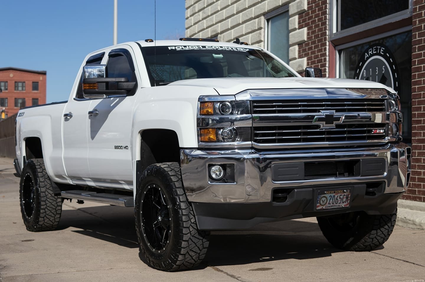

Looking to get a new set of UCA for my 2015 2500HD. Right now I have a 3.5" rough country lift, and am looking to upgrade from the rough country ones to something a little beefier, and hopefully will improve my ride quality. Currently leaning towards kryptonite.  Seen a lot of good reviews on them. Anyone have any input, or experience on aftermarket UCA for our trucks? Also looked at cognito and readyLIFT. Downside to ready lift was that they require quite a bit of trimming from what I hear. Thanks for the input!
