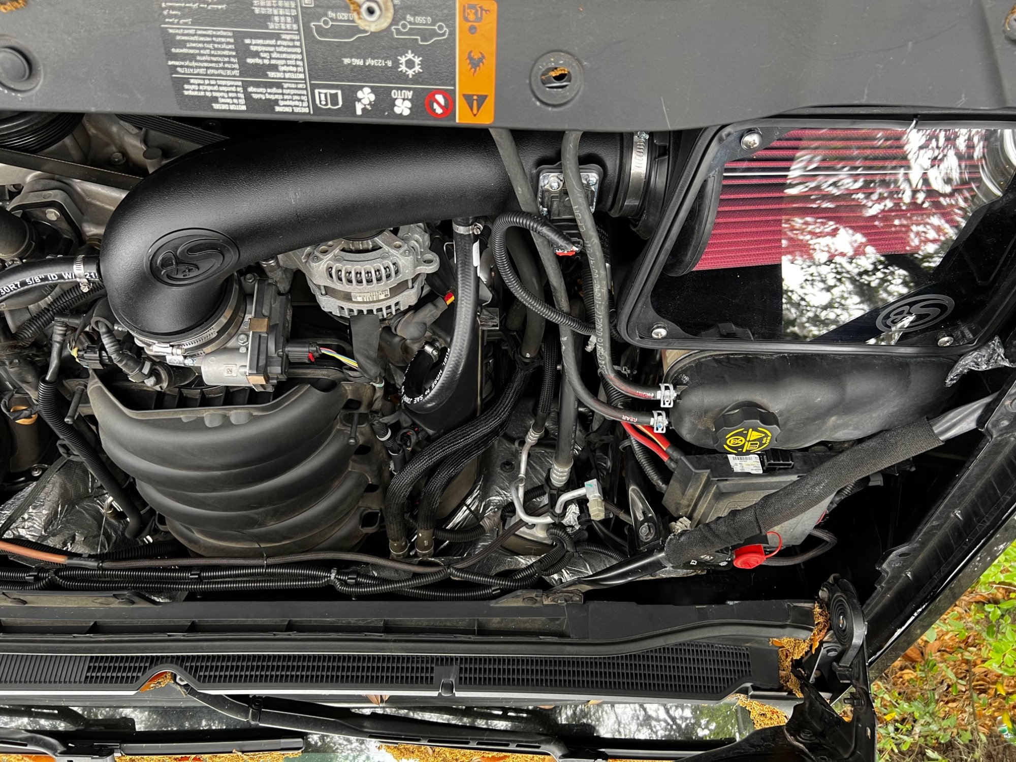

I installed the kit today, did the battery disconnect as they stated. Not quite sure it was a full 2 hours, but I reconnected everything after I finished and started it up. It ran fine and after a few minutes stated idling 1423889E-3682-43AC-9611-BCCE3B15013D.thumb.jpeg.db7755a880b09419e0d2c92bd914681d.jpegerratically and threw a check engine light. The code was for the MAF. I disconnected the battery again and will wait 3 hours and try again. If that doesn’t work, I’ll replace the sensor. I guess those things are delicate, but I was careful with it. Also tightened up all the clamps just in case it’s a intake leak past the sensor.
Edited by Mosesc789
either forgot to reconnect the maf sensor or you also might have air leaking past the maf too
I also recommend removing the hoses going into the CAI tube into the throttle body, plug em up, and run uni filters for the valve covers, since thats also unmetered air
Years ago I bent one of the MAF sensor pins when I reconnected the wiring harness to the terminal. Idle was terrible and my fans wouldn’t stop running. Might be something to check.
