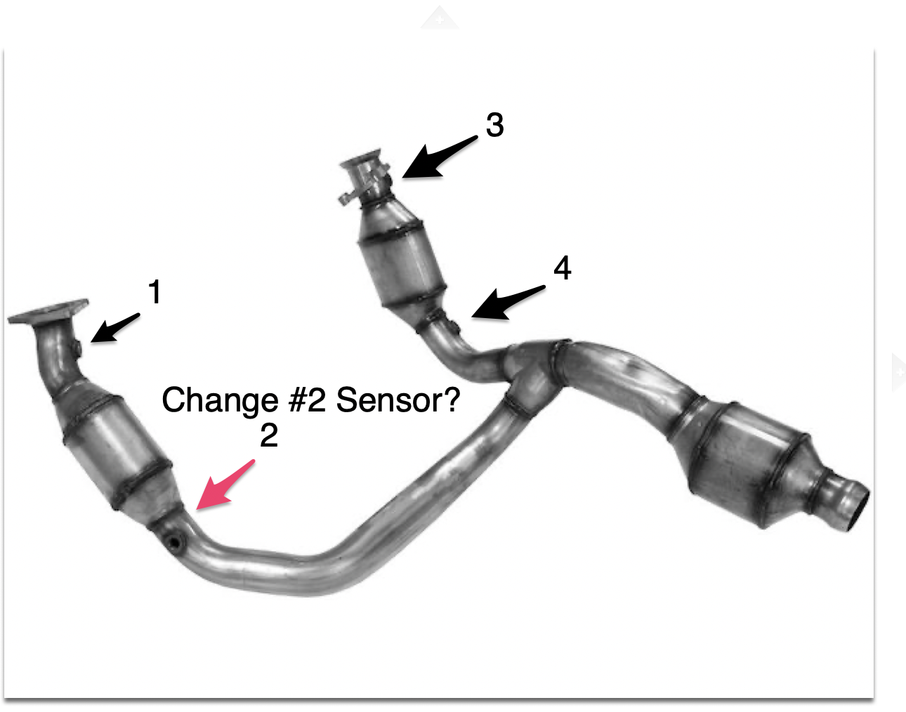

Wow, that info will. be very helpful. I will probably do as you say and try replacing the driver side 02 Sensor first. Should I replace both of the driver side ones, or just the downstream one? If that doesn't work, I will replace the individual Driver side Cat and try that.

So what fro you think about me getting 2 of these and replacing the 2 Red Oxygen Sensors? These are OEM

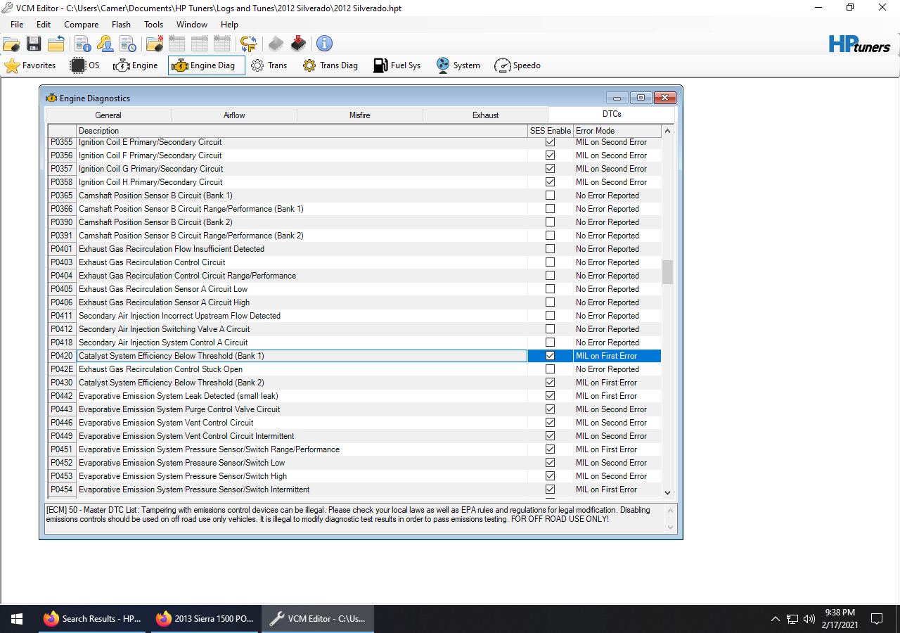

Going by the DTC list for the LS engines and this being a LS engine, that is what the codes are. Most OEM's use roughly the same DTC codes and yes some vehicles like fords list bank 1 and bank 2 different than GM or Dodge does.

518622286_ScreenShot2021-02-17at8_39_29PM.thumb.png.b322cf8bc8a61d44664f34bc5900f5d7.png
I'm sure my warranty is long gone with 132,000 miles.
thanks i have gotten the codes on a GM OBD2  both 2003 and 2008(LEV2 3way cat) models  it says bank1 and bank 2  (it will register 2 identical codes  for both p0420/p0430 besides the "bank number" being different  4 codes total.. )
