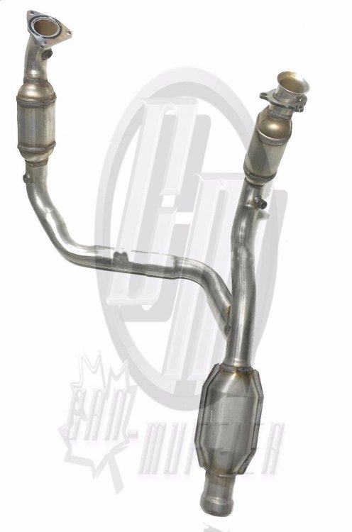

OK, so I replaced both rear sensors with AC Delco parts, and still getting the dreaded PO420 Code. I also replaced the Spark Plugs with AC Delco Originals. Still getting a low speed miss part time. What do you guys think about this part to replace the Converters? They're $400 on Ebay.
 https://www.ebay.com/itm/GMC-SIERRA-1500-5-3L-Y-Pipe-Catalytic-Converters-2009-2013-BrandNew-OBDII/332336407404
