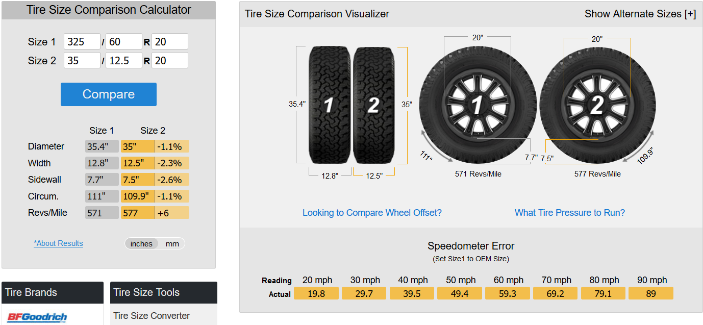

Just to keep from making a whole new thread, you wouldn’t happen to know how big of a difference 325/60R20 is vs 35x12.5 on 20” rims? I’ve got the 35x12.5 nitro trail grapplers on right now, but I found a pretty solid deal on 325/60 nitto trail grapplers. I know there’s only about an inch maybe inch and a half more tire, but will this cause any rubbing issues?
Cant tell you about rubbing issues but here's the comparison.
