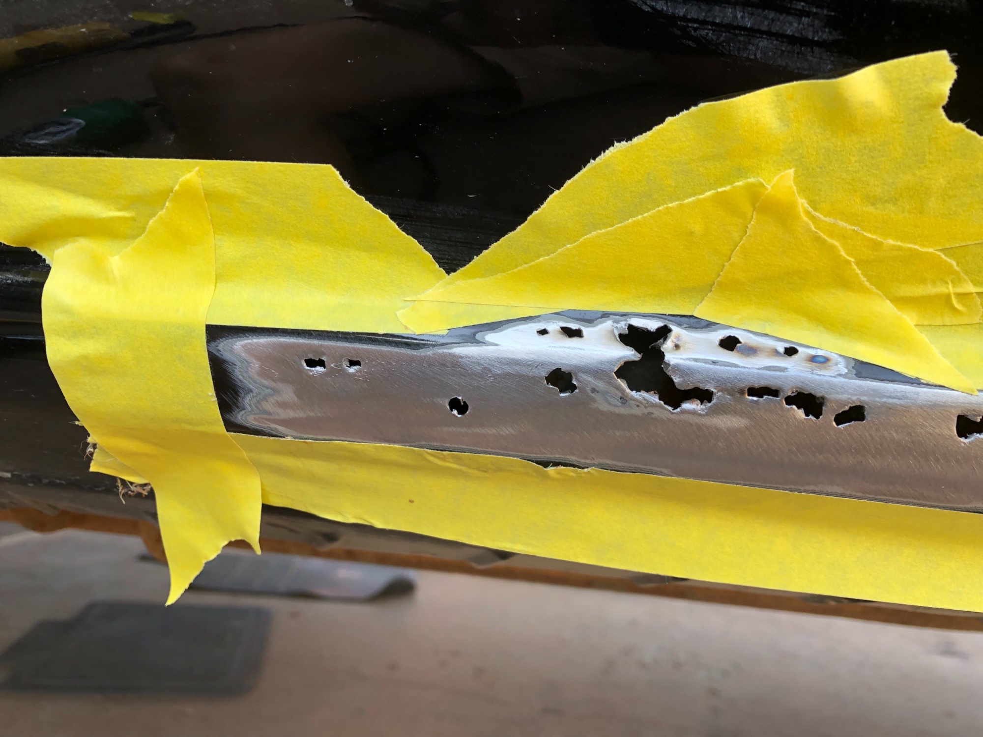

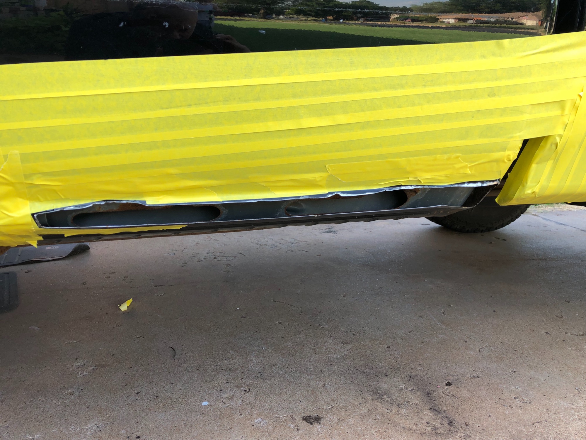

I started sanding the burrs off and sanding as much rust on the inside. I wrapped sandpaper around a drill bit and went to work. After much progress I started taping it off the paint the rust reformer and get it taken care of.

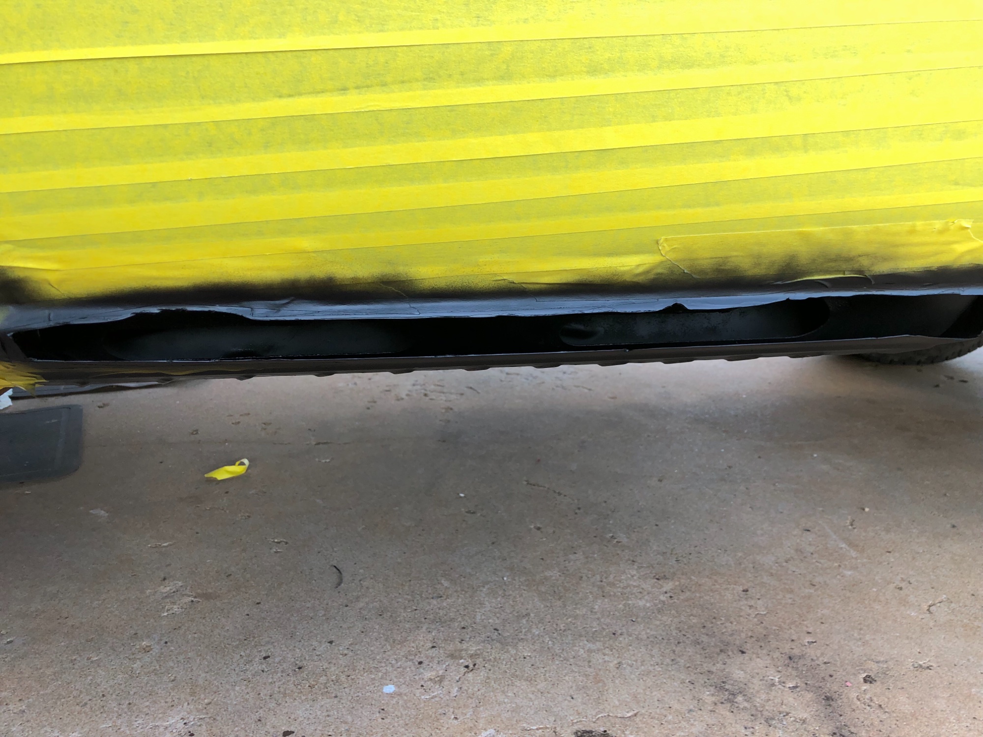

I recessed the tape about an 1/8 of an inch away from the edge. So the exposed metal will be coated, then applied the reformer as much as I can to every nook and cranny. Below is a picture of it painted
Edited by Eggs2bacon
Here’s where I’m stopping for now. Since water gets in here no matter what, this can’t hurt it too much more. As long as I stay out of the rain till I finish the repair.
