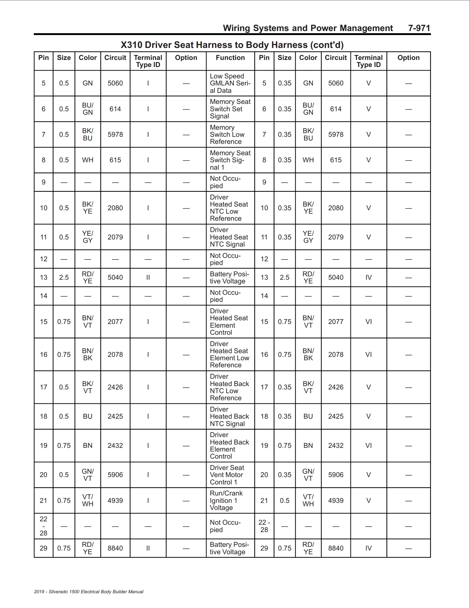

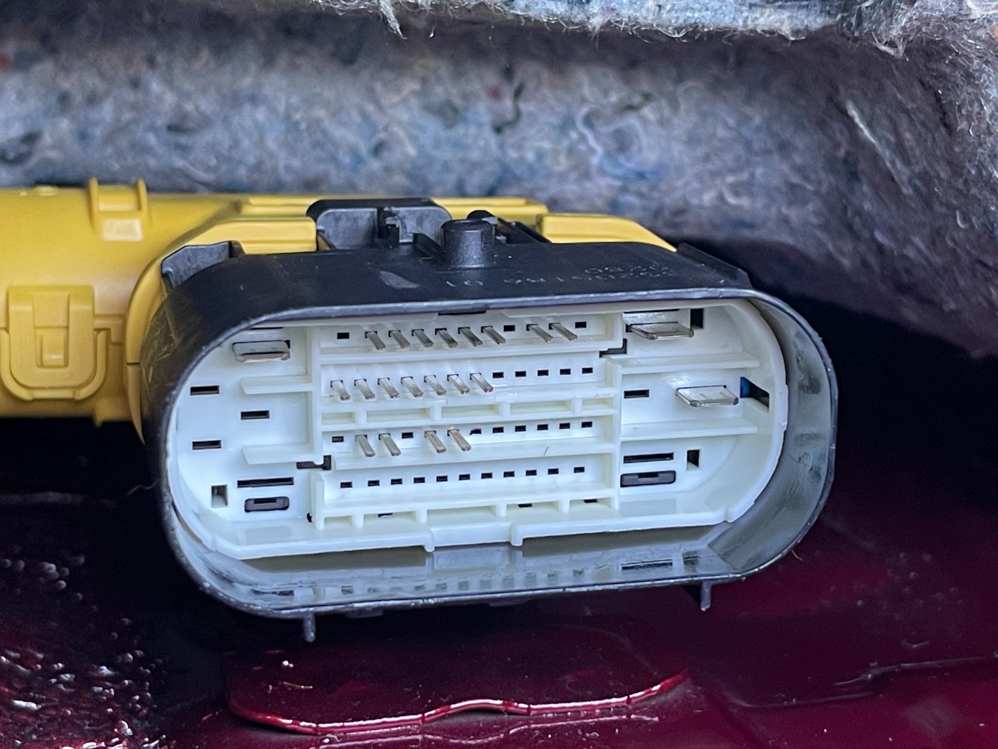

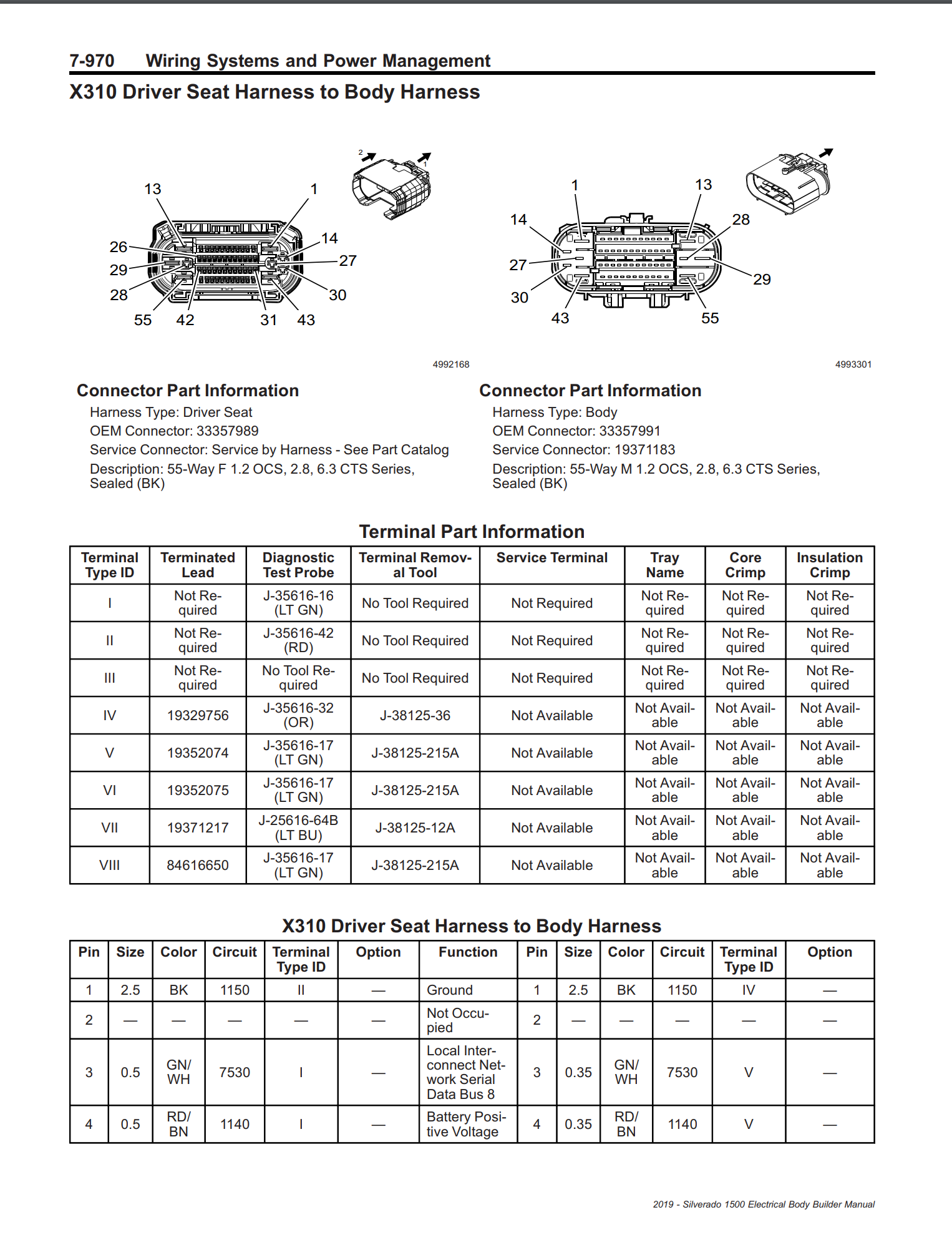

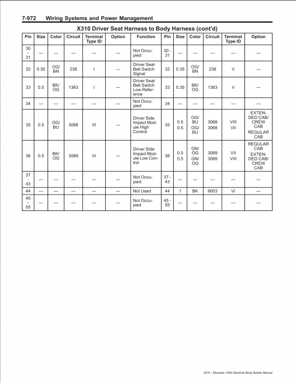

I did and I cross referenced the pins to the GM electrical body builder guide and it seems to have all of the pins there.
I'm also wondering if I could just change the seat harness to the memory seat harness, I have power drivers seat and all leather already so I don't want to buy the whole seat...
The PN for the seat harness: 84513012 (With power, Without ventilated, With memory, Without haptic alert)
If I could just switch out that harness and add the memory module and buttons and such it would be way cheaper and easier.
