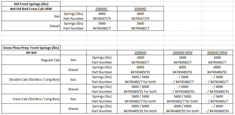

1 hour ago, MTU Alum said:
2500 diesel crew cab runs 5600 FGAWR.
Got it.  Once MTU has blessed the data as correct I would be happy to provide the simple Excel file to anyone that wants it.  In Excel it can be updated to include any other formatting and/or information you want.  Just PM me your email address.
Edited by 03 Cobra

19 hours ago, MTU Alum said:
4400 FGAWR 84745473/5
4800 FGAWR 84745477/9
5200 FGAWR 84745481/3
5600 FGAWR 84745485/7
6000 FGAWR 84745489/91
In general, diesel crew cab sb 4wd are 5600 FGAWR and gas crew cab sb 4wd are 4800 FGAWR without heavy front or snow plow options.
If you have any other models, I can look up when I have time.
#iworkforGM
This looks correct from 2020 to the mid cycle.
