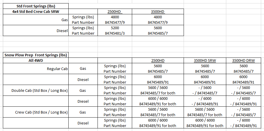

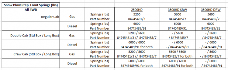

MTU, since you are our guy on the inside can you please sanity check this table I made?  It might help us bring everything together.
All gas are 5600 lbs with snow plow.
6 minutes ago, MTU Alum said:
Copy that.  Here is the updated snow plow table with a standard springs table if you want to take a glance at that one too.
