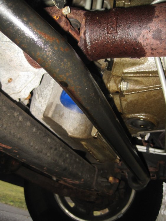

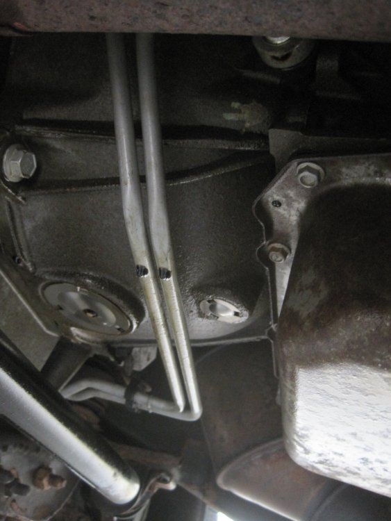

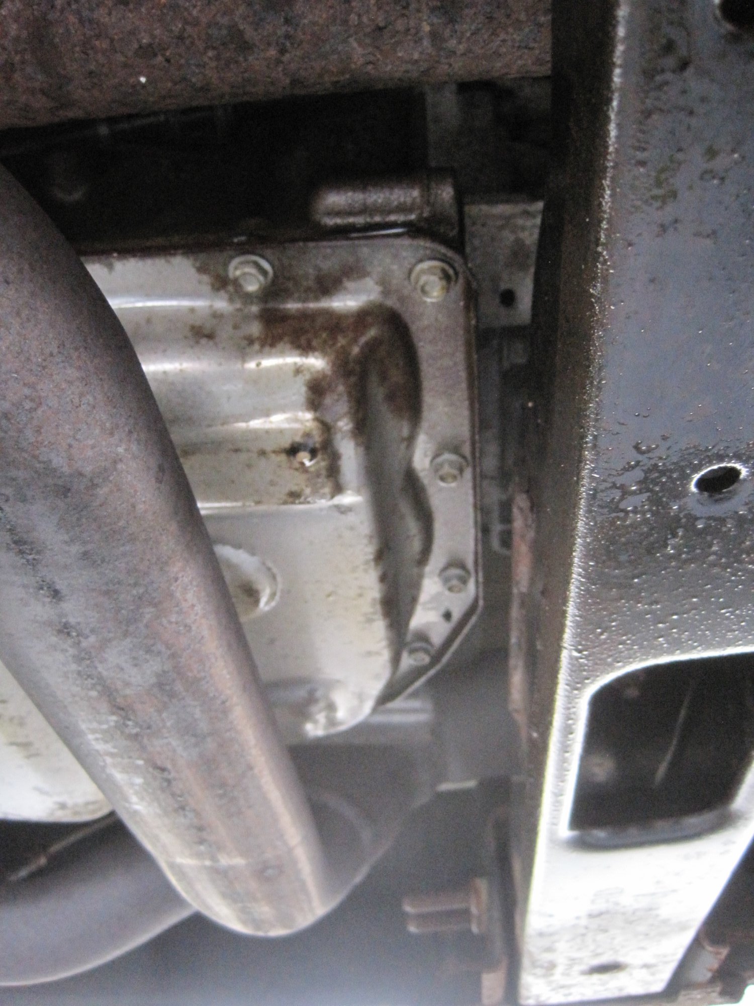

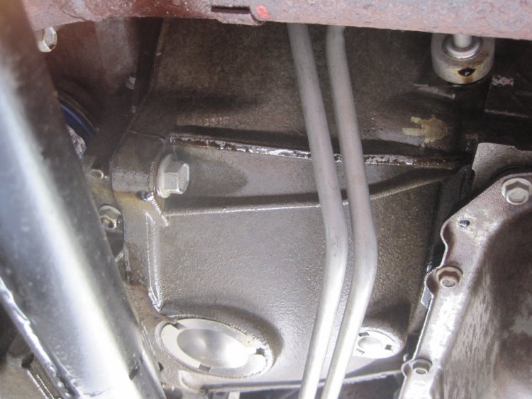

OK Mrjack, don't keep us all in suspense. Where was your oil leak? My 2012 5.3 with 60K miles has developed an oil leak from somewhere near the back driver side. Oil shows up down below on the side of the engine and bell housing. Oil even drips down on the transfer case prop shaft. Had it in to the dealer yesterday and they couldn't spot the leak so put dye in the oil and want me back in 1000 miles or so. They mentioned the head gasket but I don't think that's possible. Maybe cam cover gasket, oil pressure sensor or valve timing sensor? My torque converter and flywheel and oil filter are dry. Here are some photos.
