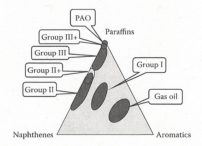

Better at what and which ones? Rhetorical question. Let's ask a question. What is the purpose of hydrocracking and hydrotreating? That thing that turns a Group II into a Group III "Synthetic"!
To REFORM the molecules from aromatics and unsaturated structures to shorter fully saturated straight and branch chained molecules.
And what does this do? It makes it harder to thermally and chemically decompose. Slooooows oxidation. BUT it does not prevent it. Antioxidants are still required and those chemicals are the same as those used in Group II fluids and are HEAT SENSITIVE. They (the additives) decompose in a Group V just as fast as a Group II and are the fluids first line of defense. Once gone (depleted) the fluid must rely on chemical structure so yea, it last a bit longer but it will not stop speeding bullets or jump tall buildings in a single bound.
Know what else this processing does to a mineral oil? It breaks it's viscosity to the point than non oil viscosity modifiers which are shear sensitive must be added OR blending with a lower group mineral to bring back the viscosity which also brings back some aromatics. It pollutes it.
It could also be blended with a PAO which would enhance BOTH viscosity profiles and inhibit oxidation BUT they cost money. Money that is NOT normally used in "Full Synthetic" fluids.
