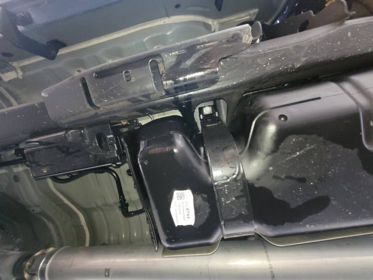

Has anyone seen anything on an issue with leaking fuel? I drove it yesterday and smelled gas in the cab. Today I smelled the same and I noticed it dripping after i parked. It is hard to tell where exactly it's originating. Help?!?
Looks like maybe it’s leaking from the connections at the top of the tank. Should be covered by warranty. Why not take it to the dealer?
Yeah.... I crawled around for a bit trying to see if one of the connections was loose because I wasn't sure how much it was going to leak or when I could get an appt. I got one single drop of gas in the eye which was all the motivation I needed to make it not my problem. I booked an appt for 8am tomorrow at a local GMC dealer so it's now dripping on their lot...Nice to be able to do that online :)
It was a cracked high pressure fuel line , not much of a surprise but I wanted to close the loop here. It is going to be about a week for the part to come in.
