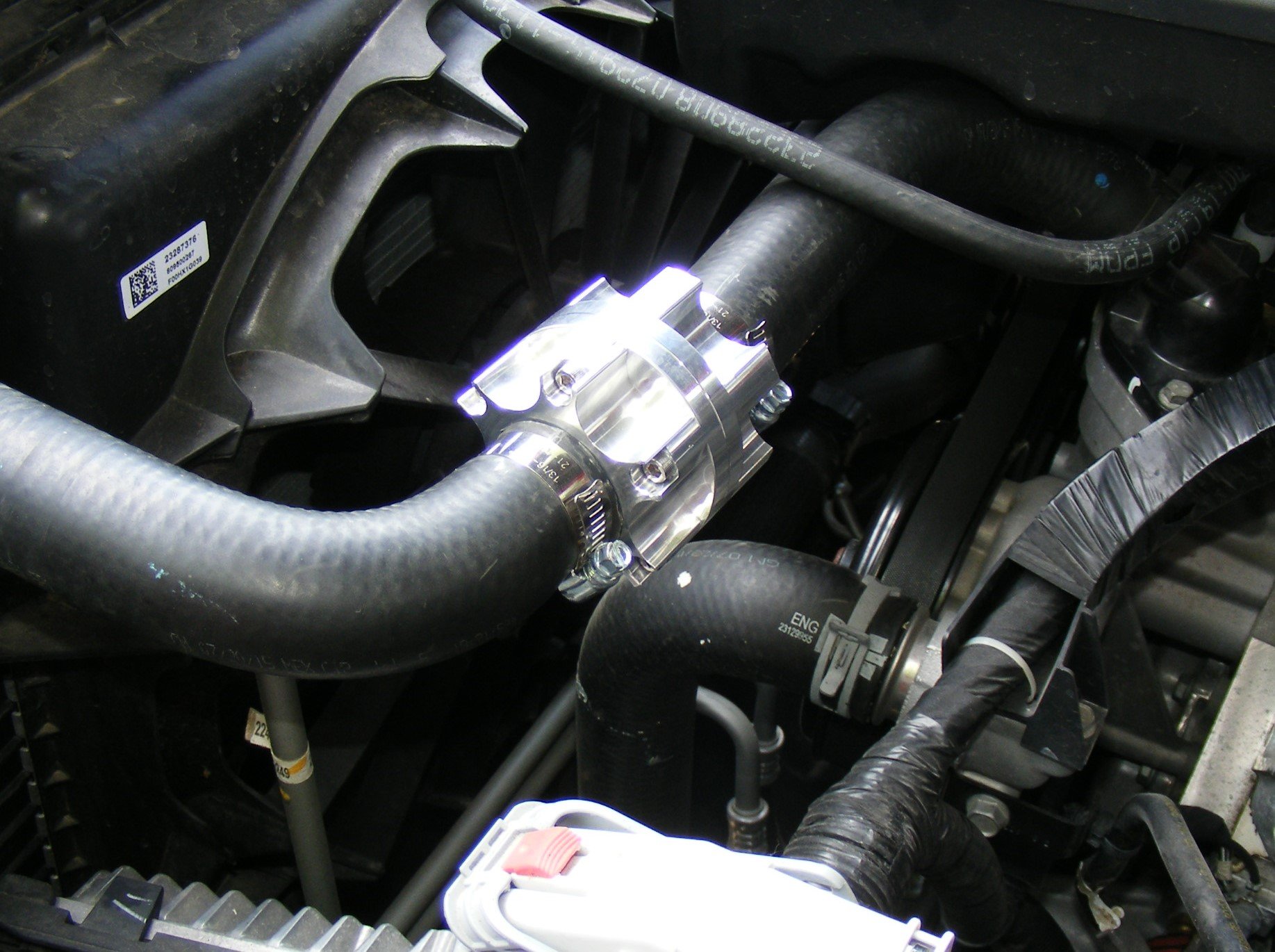

I just had a major, major mechanical fiasco the other day.  The truck just wouldn't get up to temp so I watched "her" real close.  Normally, I have AM radio cranked up and HOT COFFEE and paying attention to the other idiots on the road seems like a better idea than watching my dummy gauges.  Long story short is $70.00 for a thermostat/all in one with housing about made me crap my pants because prices are going up but this is rather obscene don't ya think?  I don't know what else to say really other than I am gunning for Cadillac Luke on mileage and keeping Grumps at bay from my mileage!

Sticker shock on that thermostat? They were at one time listing $90. At some price people just quite paying. I pitched that over priced scrap and installed this from IPSOCO and run a standard good old 54 mm SBC Stant or Gates Super. Not a breakdown part but a "Shinny...I want Precious" sort of thing.

turned 150k this week. finally just did brakes and rotors, found both rear seals leaking so i replaced them also. a week later the pinion seal is leaking wtf. had to put the truck in the shop to change the thermostat for a second time because it wouldnt get to operating temp. i decided to check the rear axle vent and found it was plugged at the hose connection on the diff, cleaned that out and no more rear diff leaks. i know my tranny is on its way out but will see how much further it will go

I replaced factory fill at somewhere around 15k.  Something just didn't feel right and have replaced with brand new fluid every 30k +/- a few k.  The wire harness in trans that read Temp failed.  I put new shocks all around probably around 30k with Bilsteins and actually think it's time to replace again but that was 4qty for under 400.00 and that ain't happening again....LOL probably more like 1k now because I want the all in ones with springs.
This is the 8speed as stated in post and honestly it's finicky loves HIGH/TEMPS and high torque!  Lug the trans and it will ride like ******!  Smash the peddle and it's quick and smooth.  It's 100% dependent on the intake and GM 8-pin MASS with humidity or any relative humidity in the air!  Change anything on the 8L90 that effects temp and ECU readings and it shifts like ******!
Trust me put in a different T-Stat to affect the time to operating temperature which you may never get to in higher latitude areas during winter driving even after 1hr+ driving?  Everything is catalogued and documented on this fine,fine automobile.

AC thermostat for our Suburban was $35 on Amazon.  From what I found out after the fact, you can change the actual thermostat and not have to get the entire housing.
1 hour ago, silveradosid said:
do you have a part number for just the thermostat
GM Genuine Parts 15-11125 Water Pump Outlet Assembly with Thermostat
