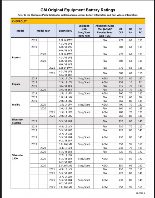

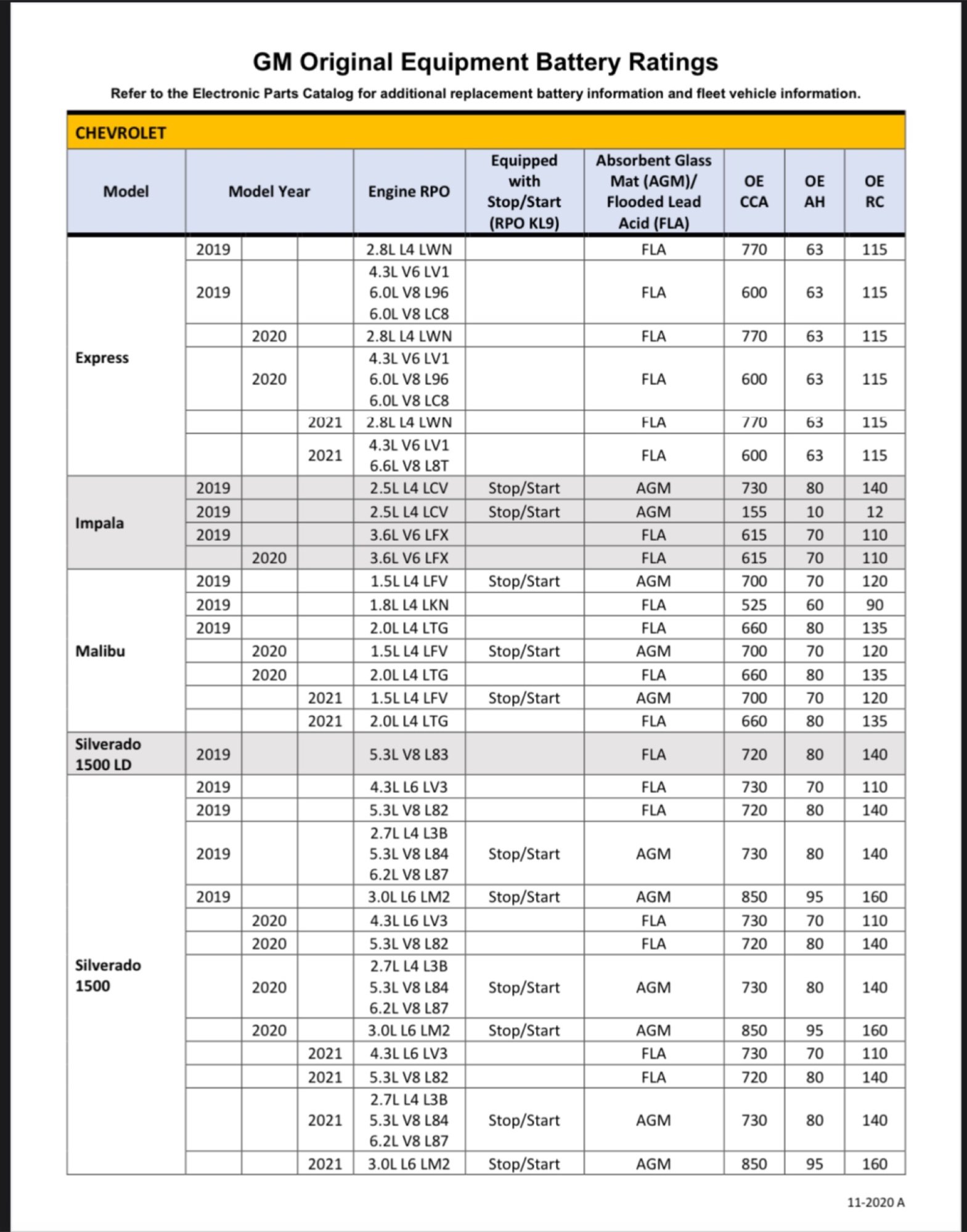

Also the 2019+ trucks came with both style batteries from the looks of it. You can buy either or. GM Parts Direct and same with Napa online list both options for these trucks.
Fun fact too, GM only lists one alternator for the V8 trucks too. So the charging system is the same for both batteries. They also already have a smart charge system that is PCM controlled, been that way for 15 years now. Not trying to discredit the above post but it's not as complicated as he made it sound.
