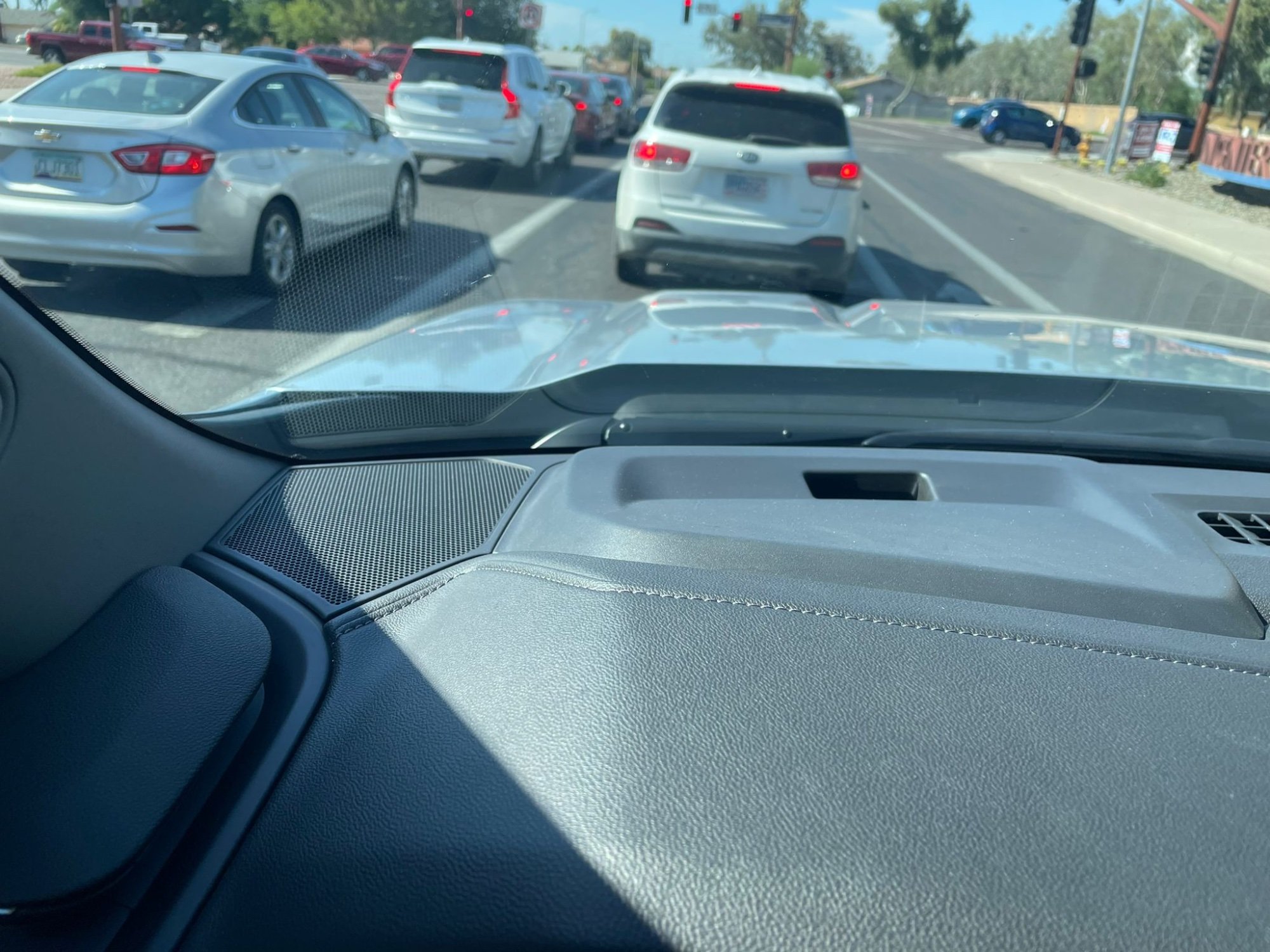

Hey, sorry for the delay.
here are some pictures of the piece that you have to remove. It’s just one piece, stretches across the entire dash and held on with clips.
as I said before, there are some tabs that extend into the A pillars so you’ll have to remove them in order to lift this piece straight up and remove it.
there are two bolts on each of the grab handles that you have to remove and then you just pull outward on the a pillar. Pretty easy job, you can’t really mess it up.
