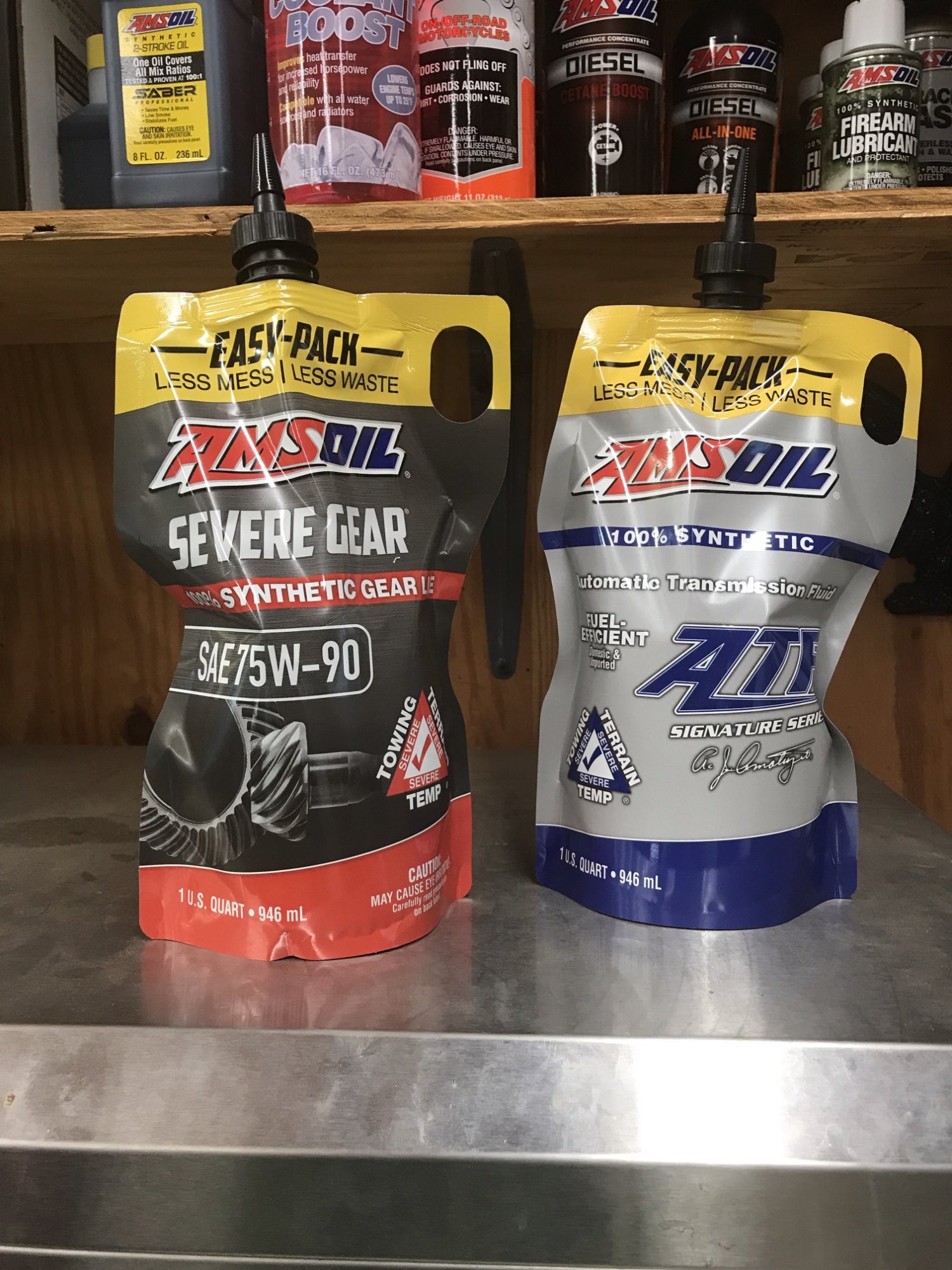

Use 75w-90, like Amsoil Severe Gear. Or any other full synthetic fluid. If you have the G80 code for your rear end, NO additional modifier is needed
  • Like 3
  • Thanks 1
Like txab stated 75w-90 is what you want.  The Easy Packs are sweet.  Yes the gasket is reusable.  You will need 3qts.  It will not take it all just to let you know.
