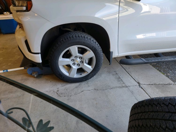

Looking at these wheels and tires for winter time.  Does anyone know the smallest spacer I would need to clear the brake caliper?
Product photo of Chevy Rims Tires 6 Lug
I happen to have a set of those that were on my Avalanche in my barn. If I get a chance in the next couple days I'll try to throw one on and see if it clears without a spacer and if a 1/4" spacer is enough. I have to run a 1/4" spacer for the aftermarket 20's I ran on my Avalanche on my 2021 Trail Boss.
I can confirm they do not fit without a 1/4" spacer. The inner spokes hit the inside of the caliper. Usually the spokes hit the raised portion of the caliper. That's why I had to run spacers for my aftermarket rims.
