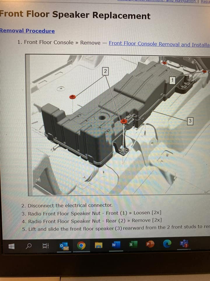

I was able to confirm that the Bose in the refresh is a 7-speaker system by a GM tech from a 2019+ Silverado group on Facebook. See the pictures attached. It is a 4.5" sub with the mounting holes measuring 160mm horizontally in an enclosure under the center console.
I was wrong and didn't have my console apart enough to see it.
Really... 4.5" sub-woofer, what a joke. There's your reason for non-existing bass. Thanks for the feedback that the BOSE system do have the 7-speaker setup.

Ok, just so you all know, if the vehicle has the bose system, whether 1500, 2500 or 3500 the subwoofer is located under the console upside down pounding tunes into your floor.  Access to the sub wiring is from the passenger side.  remove the side cup panel at the top, below that center cup panel is the sub sitting directly below it.  I went to the front of the console where it connects to the dash and started to pull firmly and broke the plastic rivits until i reached 3/4 of the way back.  There is a set of cords going into the console near that seperate into the usb electric charger and the sub.  They are in the same harness.  The sub lines connect sideways into the sub below the back side of where the ornate wood trim would have been.  I will have a video on it soon.
