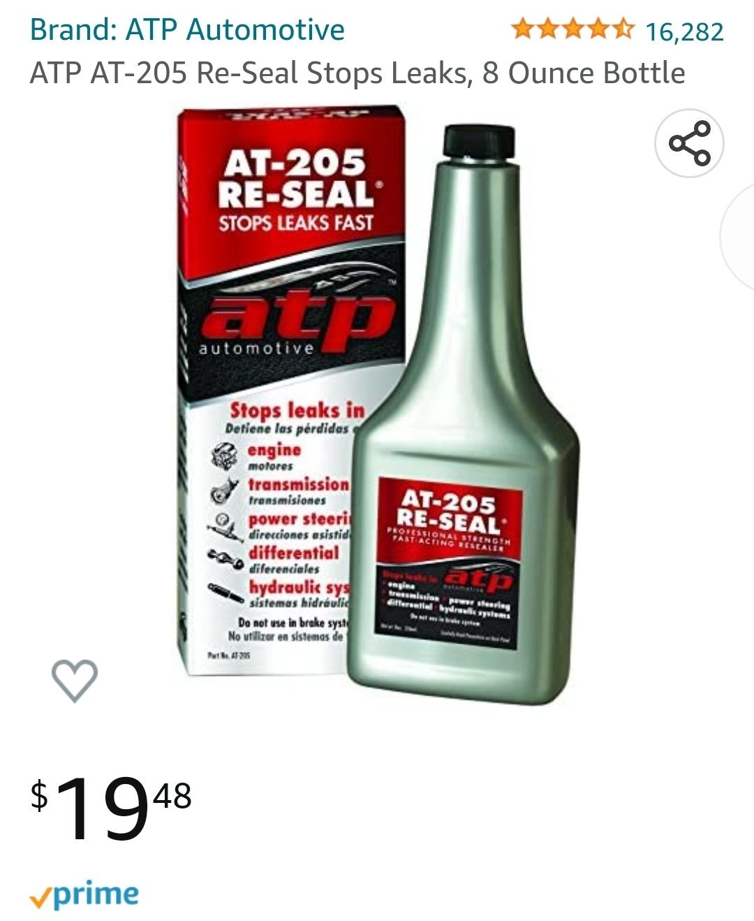

Before you do that, which I don't think is correct, put about 2 Oz of At-205 sealer in it & see iff it doesn't fix ur leaking. I just did this a couple months ago on wife's SUV on rear diff. It started leaking after I changed the GL5 oil (75W90) Red Line in it. I squirtted about an Oz. Of AT205 in diff. Case & it stopped the leak within a week. Good stuff. It softens & swells seals.

Cool, thanks for the suggestion. Did you top off the diff with oil first then add an ounce of the sealant?
No, it was a little low when I removed the fill plug, so I added 1 Oz because my diff only held about a quart & then top it off.
