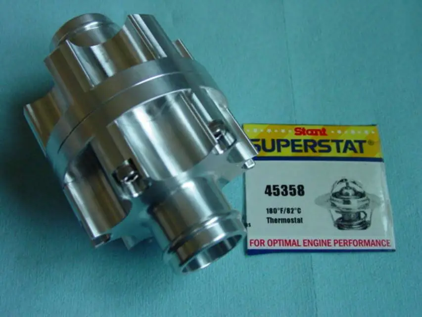

I gutted the housing and installed this from IPSCO.ORG in the upper hose using a standard 54 mm SBC thermostat.
Allot of thermostat choices when done like this. I had them scallop it, but self-item is not so machined.
Currently running the Reische Racing 170F stat summer and winter.
Shown spliced into upper hose below.
I really like your idea.
Does having the thermostat in the top hose change anything, like the way it heats up and cools down ?
That first cycle is a bit slow, yes. But as I use a 170F thermostat it's 'late' is sooner that the factory 'normal'. So and issue that isn't. :) After the first it acts as normal. The Riesch Thermostat has a brass body and acts pretty quick to upsets. Someday I'll move that small bypass hose from the factory neck to the EPSCO holder and it will quicken.
I don't see the scallops as an option on their website.
No sir. Custom work I ordered.
Edited by Grumpy Bear
8 minutes ago, Earl Cordova said:
It looks like  the Reische website only has t-stats for Fords ?
Where did you find a Chevy t-stat ?
Reische Performance NB-54 170° Performance Thermostat (lethalperformance.com)
Both 54 mm and if you look at that page this list of engines it fits includes Ford, Chevy and even some Chryslers.
Thermostat doesn't know what name is on the valve cover :crackup:
If you buy from IPSCO he supplies a rapid response STANT or used to. It's a 180 F.
