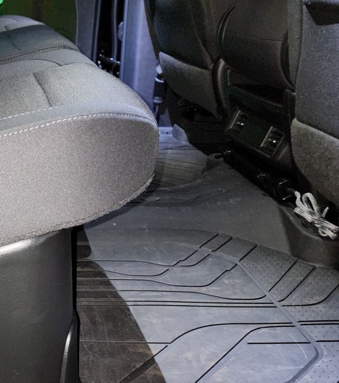

Very true statement.  I ran a cord from my dash outlet to the backseat area under the 2 HVAC outlets to a 5 outlet strip cord with 2 USB's in it so that anyone in the backseat could use it to charge their phones or I can charge up the batteries for all of our Bauer 20V electric accessories that we have.  That's probably the best use for what little amps the outlets actually put out.
If you look real close under the vents you will see it.  I used 2 zip ties to secure it to the all weather mat.  Not perfect but it works great.
