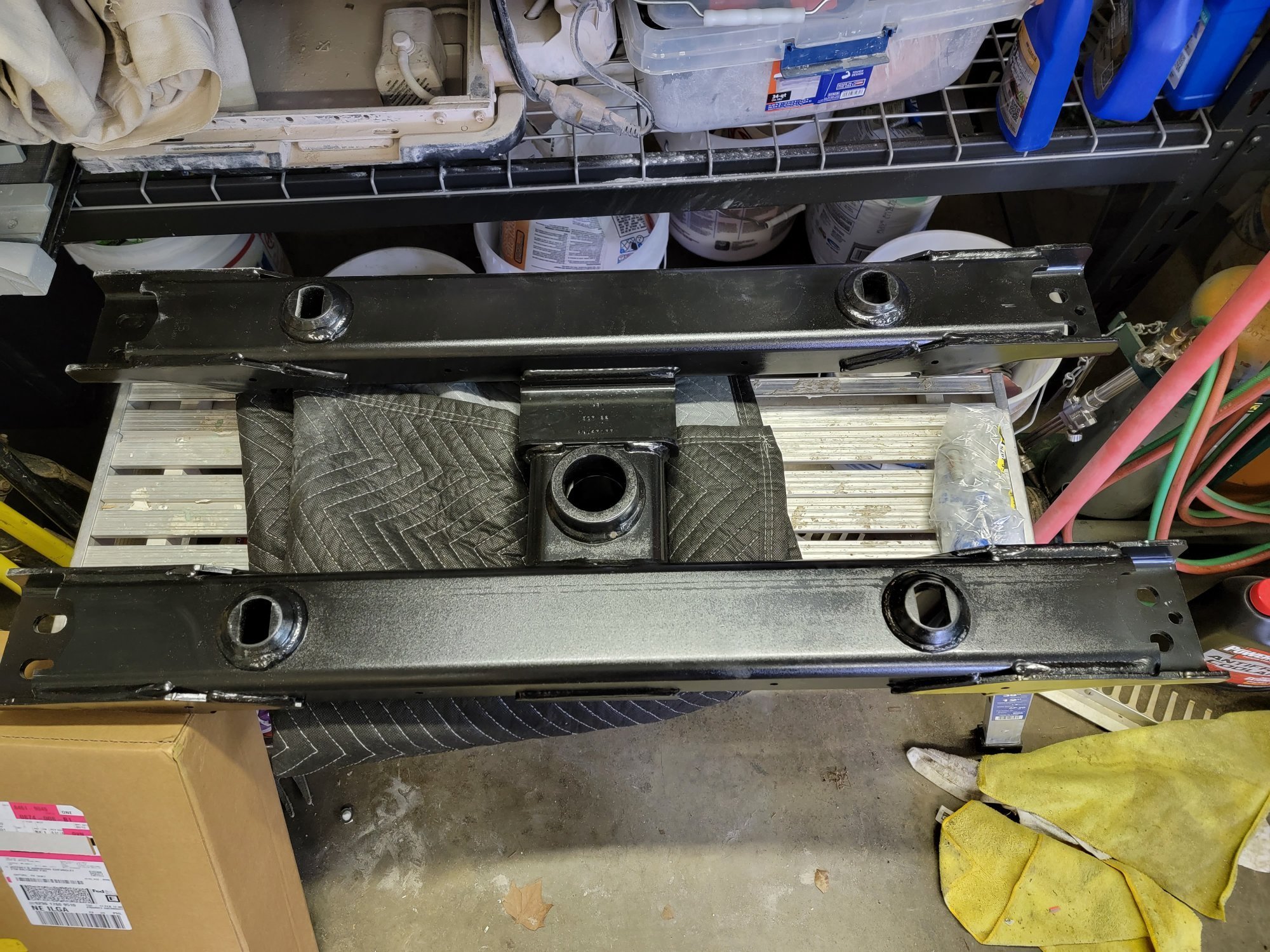

Has anyone added the 5th wheel prep package? I am having a hard time finding all the parts, dealer was not helpful. No videos of GM being added, Ford and Ram have the complete package and videos.

I did buy the bracket, bolts and heat shield from my local dealership, $1400, hoping to install this week. I had to find the part numbers, they had no idea what I was talking about. GM is missing out not having a package. Not everyone can just trade in their truck to get a 5th wheel.

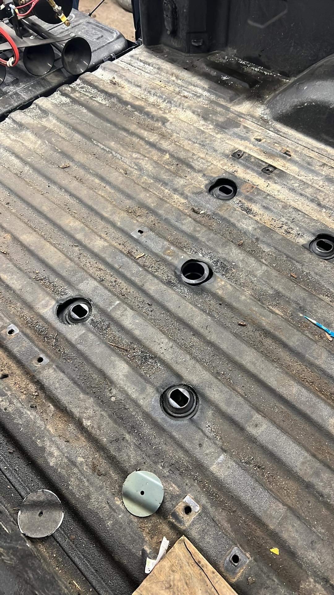

I bought a factory gm puck system on eBay for $325 used factory hitch bolts and just trimmed the heat shield the whole thing was simple to install just nerve racking drilling 5 3.5 inch holes in the bed

Yeah the bed comes off the puck system slides across the frame rails and bolts on.

No cross members are not there. I bought the entire puck system mount on eBay and it just bolts right in…don’t mind my bed it’s dirty as hell and the goose hole is just a hair off

That answers my question.  Thank you for that.  325 is cheap for what you just added.  Kudos to you and I bet this helps others that want to add this to their truck!!  Excellent post and your bed looks amazing and you did an amazing job cutting those holes getting them lined up.  Great job sir!!!
You got lucky buying the crossmember that cheap. I paid $1400 for crossmember, 8 bolts and heat shield from dealership.

Yeah I called the dealership and ended up looking on eBay found a store on eBay that had like 8 of them listed it definitely worked out….the heat shield is dumb I just trimmed a tiny piece off of mine and it worked fine. Also when you go to put the bolts in I’d suggest spraying them with copper, the holes were all nasty
