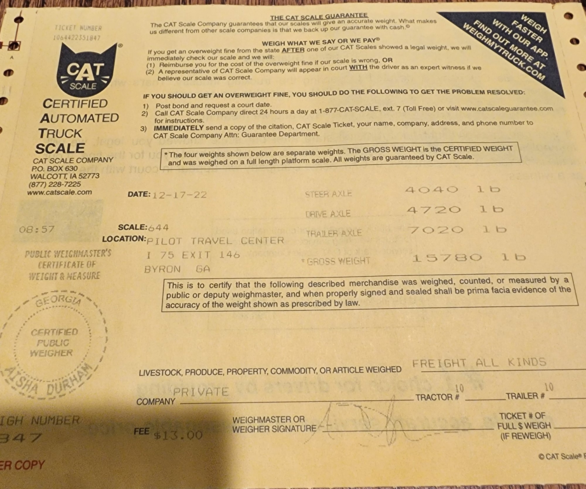

@ChrisG-2019  I just looked up your camper.  The numbers from the factory are low, they all are.  Think about the weight in front of the camper say in the pass through along with clothes and everything that can be stored perhaps under your bed, along with at least one battery, 2 propane tanks and you are getting close to 1k lbs.  I have no idea of your weight ratings for your truck, if can take a pic of it and post it on here it will certainly help.  And you might be ok because you have max towing, but look at your capacity numbers.  I'm guessing you will be running out of room real quick.  That's why I always suggest at least a 2500 to be safe.  But who knows.  Do the math on your truck and I would love to help with that.  Do you have CAT scales near you?  That's really the only way you will know for SURE if you are over.
  • Thanks 1
Here's the CAT scale ticket we got.  That was with a full tank of water on our GD imagine that sits right in front of our axles.  I was trying to get the highest number I could get in the event we went boondocking somewhere and needed a full tank of fresh water.20221217_181130.thumb.jpg.dca8dc772ac88cea355b88059f994cfa.jpg
Jettech.  My Silverado has 11.3L tow rating and 1130 tongue  weight so my camper is well within its range. The 25RRT  has a gross weight under 8K and a hitch of 690 lb.  My truck can pull it fine, but a 2500 with its size and weight would not work as hard.  While my Silverado gets better MPG non towing, I find towing the 1500 and 2500 (gas) get about the same MPG (I get a average of 9 MPG towing with 1500).  I am in northern Virginia is there is no cat scale near me.  Have a friend in PA that I may visit at some point that has one within a 25min drive.  Appreciate the info and feedback.
