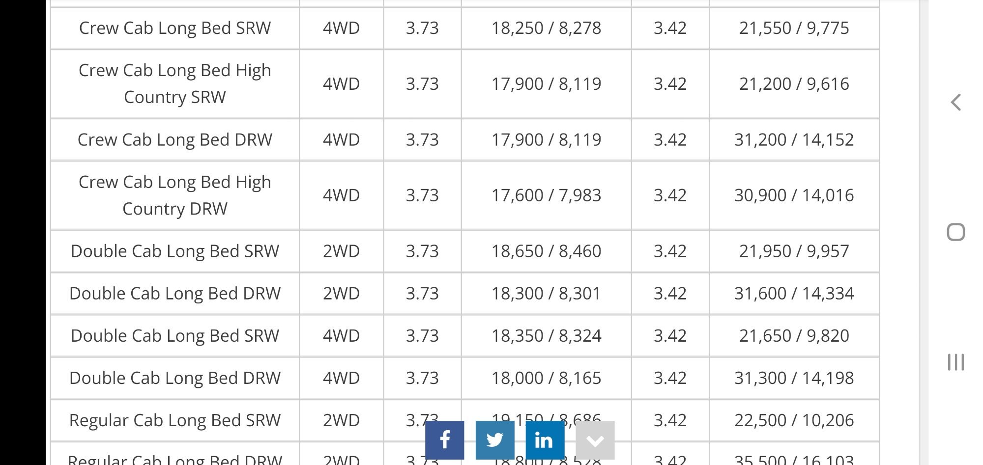

Pay attention to single or dual rear wheel load capacity with the gas motor, if i am reading this chart from GM correctly, the 4x4 crew cab long bed single rear wheel has a higher capacity than the same config with the dual rear wheel specified. 18,250 single rear wheel, 17,900 dual rear wheel.

In the end, both trucks can probably haul close to the same weight, if modified. But the factory sticker on your door jamb will still be the final word when it comes to law enforcement.
