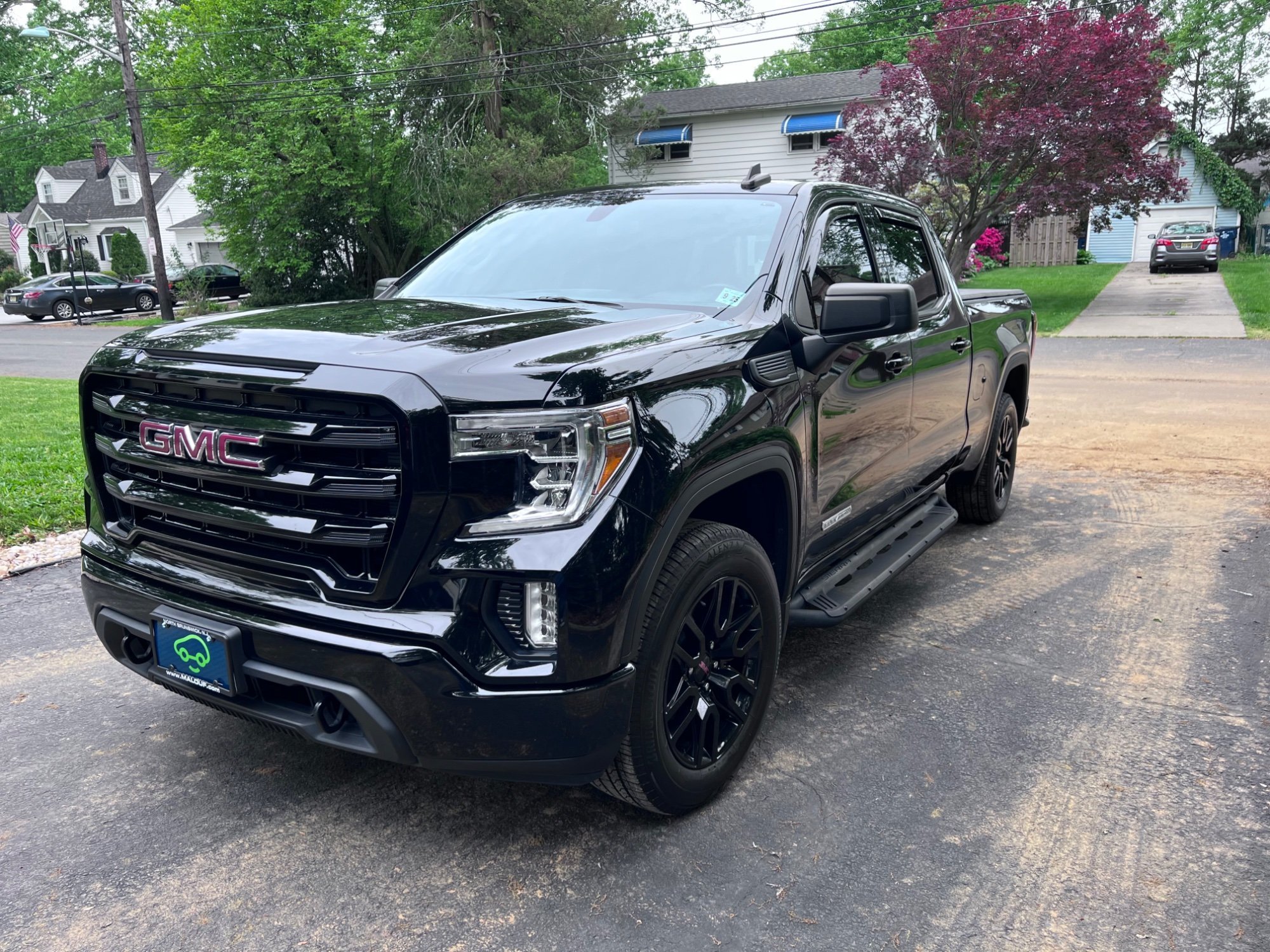

What is the next radio upgrade I can do? Looks like my truck came in with factory installed IOR and I want to update it to the next available option without the navigation system. Wireless CarPlay perhaps. Maybe be able to add trailering option in the future? Any help highly appreciated, thank you
Welcome to the forum! Sorry to say upgradng an IOR radiio is extremely difficult if not impossible. Everything in your truck is designed for IOR not IOS or any other radio. I have heard and read about others who have upgraded and they spent alot of money and lost some funtionality form the sound system. You could research this forum for more details or try White Automotive Services.

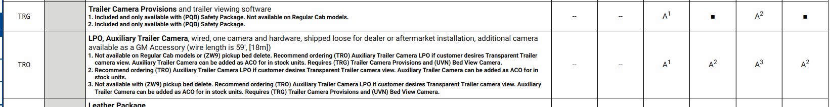

@fernando flower Have you figured out how to upgrade your infotainment system from IOR to IOK? I have a 2024 Silverado 2500HD with IOR infotainment system and also want to upgrade to IOK so I can add the trailering camera system that includes side blind spot cameras and front camera. From what I can tell GM does not have a IOK radio that can replace the IOR radio, so I’m hoping you have maybe found a solution?
IOK is also not optional on the trims that don't have it standard.
(some years they have optional audio upgrades orderable for some trims)
From 2024 2500 Cdn order guide
Even with IOK, the trailer camera provisions are still optional, except on ZR2image.thumb.png.90dd1fe39bd1cc2c26de46f6adb2cd3a.png
