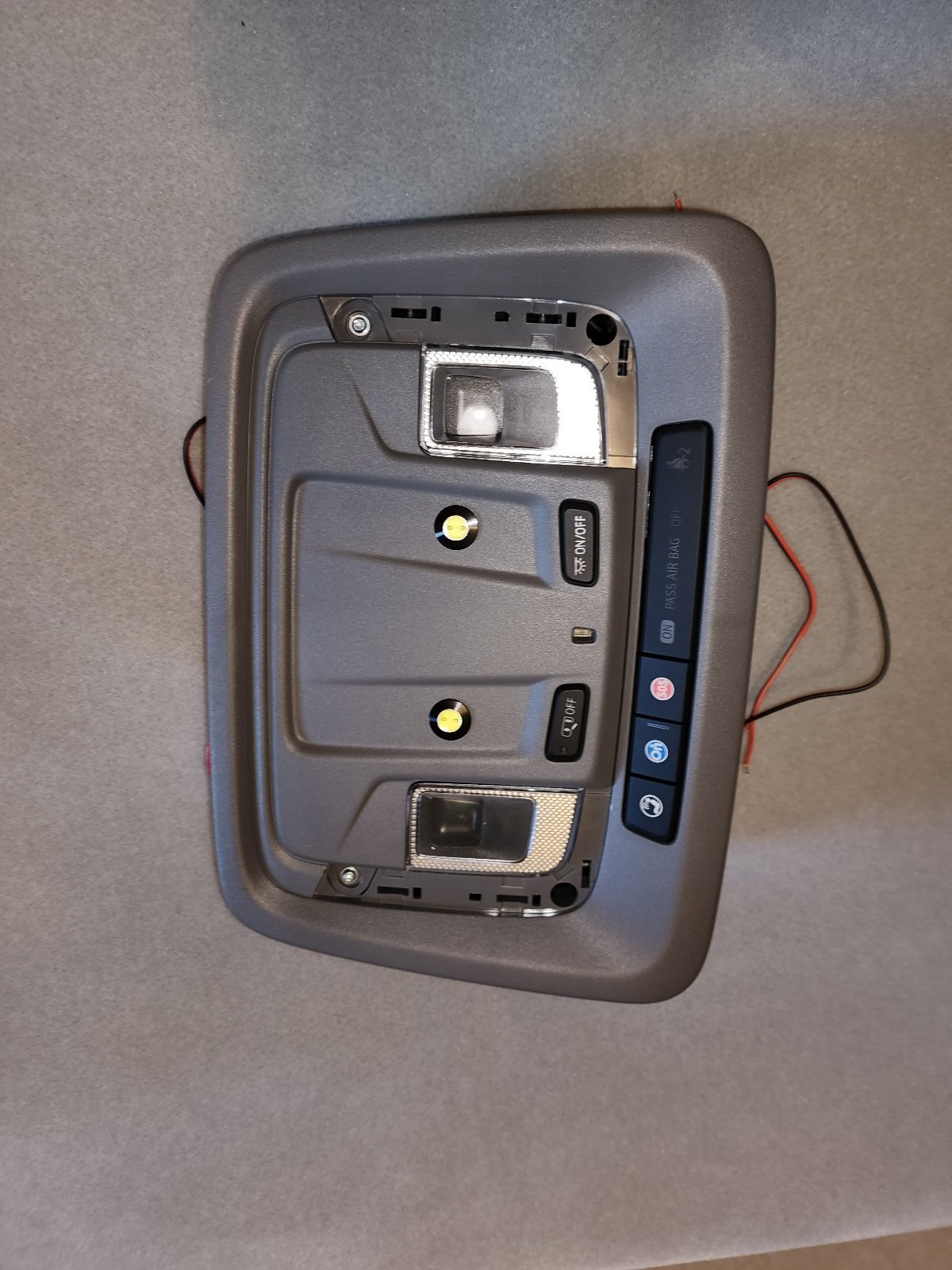

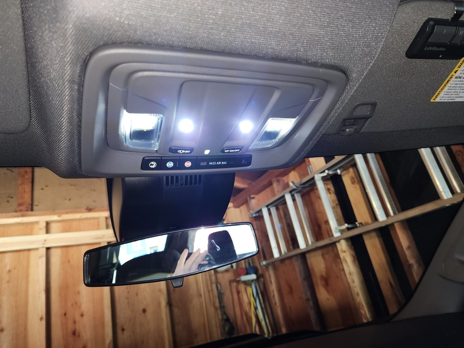

Stock interior lighting poor at best. Picked up some LED’s on line. 1 in each footwell front, 4 just above driver and passenger head front and rear and 2 for rear passengers feet. Wired to work with factory lights. Before/after photos.

Looks better. These trucks are darker than a crypt.

OP - where exactly did you install the front ones? In the headliner? I thought about it but couldn’t bring myself to do it….

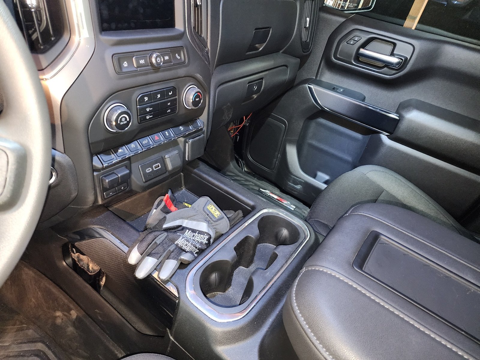

i just followed everyone else and put two in the console although I am going to try and aim them more straight down. Mine has the sunroof controls so they are aimed a little to the rear…

If its for the 2020 in your signature you should be able to find the power for lighting under the dash below the glovebox. Theres a connector with a gray wire there. It is 12v that will dim just like the rest of the lighting. If you use a couple of white LED license plate of marker lamps the circuit wont even know theyre there.
