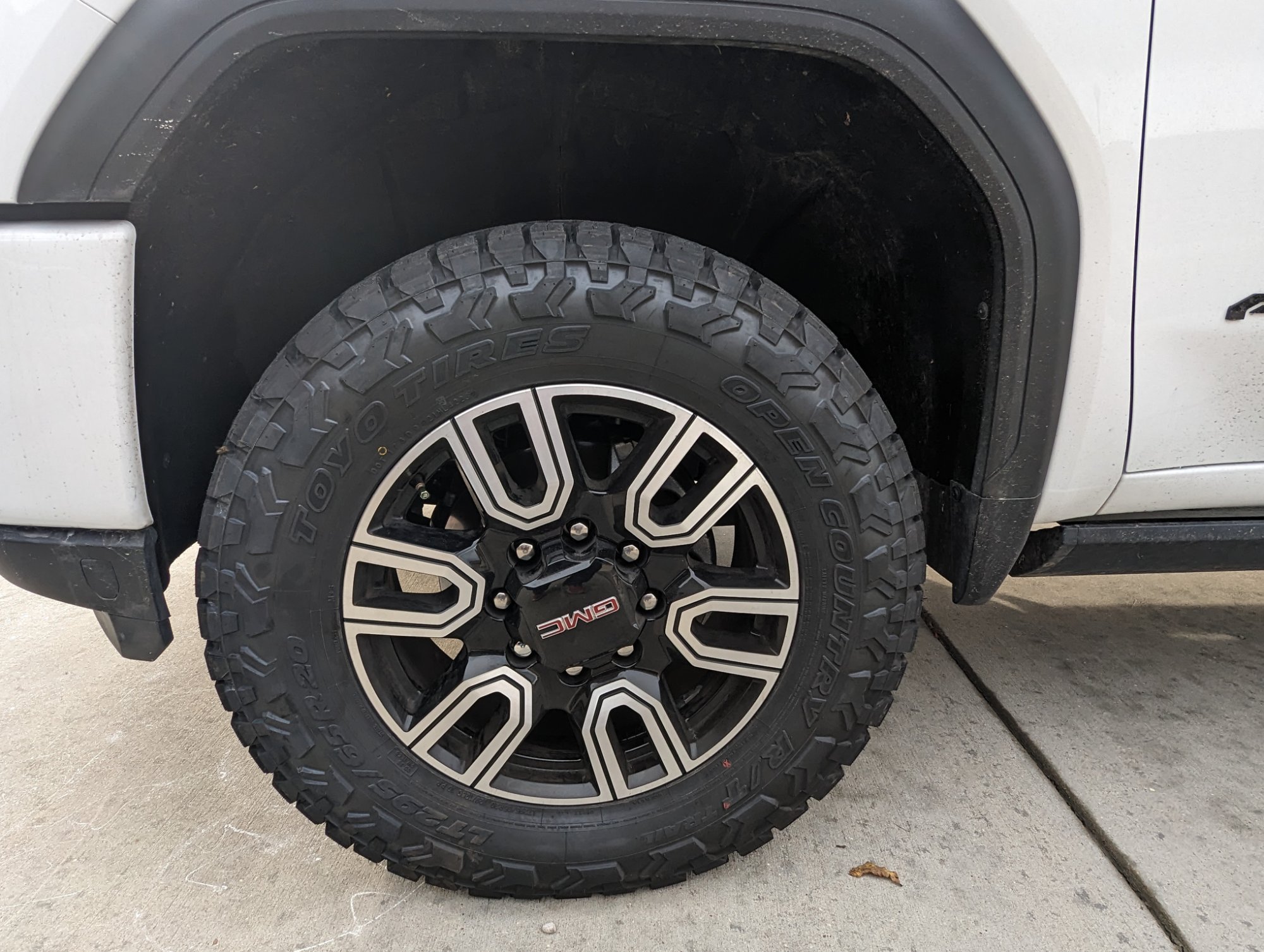

I brought my truck to a local lift shop. Explained my feelings on ride being crappy, maybe running a leveling kit, and 35's. He told me if I never planned on doing more than 35s don't touch the suspension. Change the crappy Ranchos to Bilsteins, align the truck, and the heavier tire with a bigger front print will help hide our crappy roads. He also picked the tire. 295/65/20, Bilstein 5100s and a totally different riding truck. Finally got around to airing down the tires today to 50f 45r and this is a completely different truck. Side note my speedo was 1.5 to 2 mph slow with stock tires. In town it is now dead on! Sorry the ride is dirty! On hard right angled turns I thought I had some rubbing but it was only the wheel liner. I loosened it all up twisted it around and good to go!
Edited by reb0957
