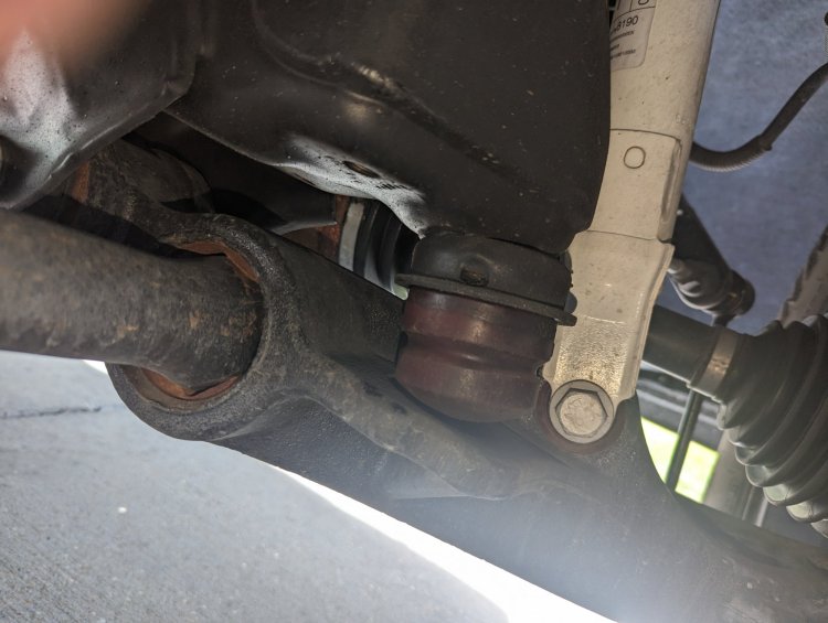

In another thread I was asked about compression of bump stops. Here is what they look like in level ground. This looks okay to me. Thoughts?
I don't have a pic of mine.  I'll crawl under my truck tomorrow and get a pic for you.
I don't know if they changed or not but you are comparing a 2018 to 2020+. That could be the difference you are seeing.
Not really comparing, just offering a data point. My 3500 truck, with springs similar to the pictured ones, with air bags, tires at 60 PSI, rides VERY stiff.
More than others? Don't know.
Am I going to do anything about it? Not sure.
If I DO do anything, I would start by taking the main spring pack apart and take the bottom overload out.
This isn't my thread so I'm only offering my insights for others to opine over.

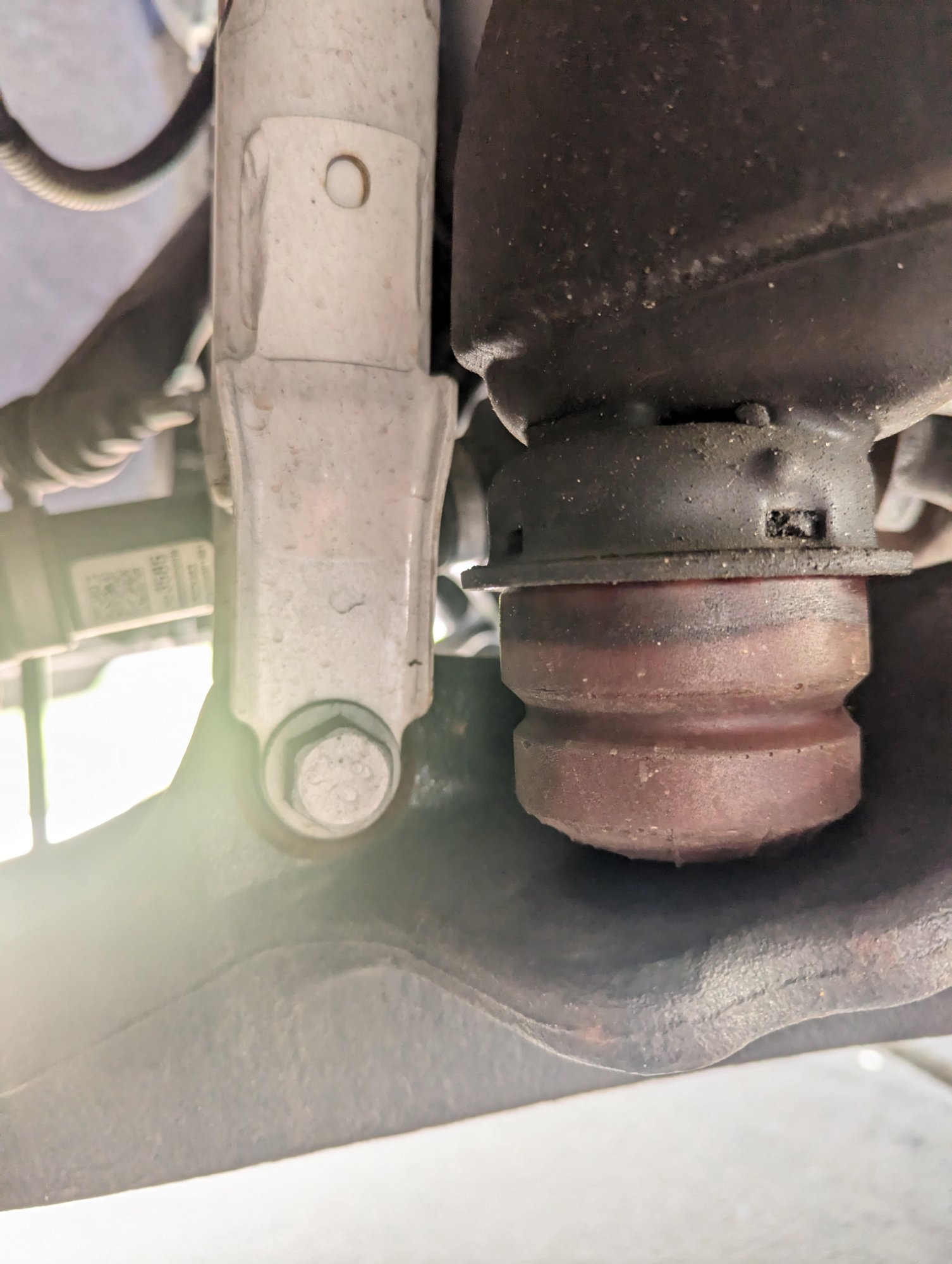

Here ya go.  Looks the same as mine..
No matter how much I read about how that is correct, I can't make my head wrap around it. To me that gives you maybe 2 inches of upward travel at the wheel.
