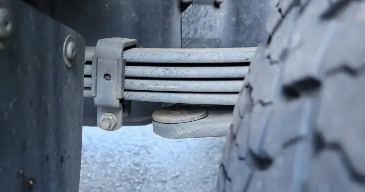

The rear leaf springs have the eight digit part number painted on them in large characters on the bottom surface, but I don’t have the table showing part number versus model. The secondary spring gaps when the truck is unloaded should look like these pictures from Jettech’s 2500:
F6C20C0C-63F7-4A0C-8629-36F9E2A26D15.webp.0bff9b9410bd36512e48ebc16535752d.webp1E342F90-ACED-46E5-B493-09066DE55177.webp.b6be8e1cc3bafc7d7f3c180d1b78d0b5.webp
If the gaps are much smaller like these pictures from my 3500, then you have the wrong springs unless you ordered the 3500 rear springs under an option I others have said is now available:
152E7C04-7BFB-43D6-A7D2-3AF5D5AEA394.thumb.jpeg.8927d39f6de93fe693d7432412b84ab2.jpeg8A2E5F31-4583-40AD-B1E7-9C55417CA521.thumb.jpeg.a73c3b86ea6df77a7581143e32b2ae0a.jpeg
If the springs check out, it may be that your shocks are overly stiff, or it may simply be that your expectations are for a softer ride than the truck provides. I know our 3500 gives a fairly stiff ride, especially in the rear seat, but it’s not horrible.  I still have my original Rancho shocks, so I’m hoping for a little improvement when I eventually replace them.
Without measuring the actual thickness of the overload bottom spring, why does yours look thinner?  Could it be just the pics?  I think we have established that the 3500's lower spring is closer to the main spring pack.  But I was looking at the pics of mine and yours and I have to say, they look thinner???  I don't know, perhaps the pic.  Your bottom overload looks to be about 1.5 times thicker than the main spring pack.  My overload spring looks to be about 2 plus times the thickness...do you see what I'm seeing?
It does look like yours is thicker. I’ll measure tomorrow so you can compare. I can see why they might have done that for the 2500 configurations that don’t have the third stage springs.

On my 2021 3500 hd cclb srw gas I measured the rear springs thicknesses as follows. This was done with a calipers and metal ruler and I feel I was accurate to the nearest 64th of an inch. I was measuring on the outside of the spring coatings, so take that into account. The primary springs are 3/8” thick, and the secondary spring is 9/16” thick.
This was a p/n 84992006 spring assembly. My RGAWR is 7250 lbs.

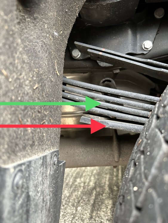

EVERYONE complains how rough mine rides, 2018 CCSB 3500 w/ diesel. I attributed it to the previous owners adding airbags to it plus its not a long bed. My spring pack has the overload spring pack on top, but I'm not sure what the overload spring on bottom looks like (regarding thickness comparison above).
Do you have camper springs or a plow package?  That will make the front stiffer. Have you lowered tire pressure when unloaded?  60 psi will ride a lot nicer than 80. (The rear tpms alarm pressure on my truck is 62 psi.)
Jettech was talking about the thickness of the four first-stage springs marked with the green arrow compared to the thickness of the second stage spring marked with the red arrow.
