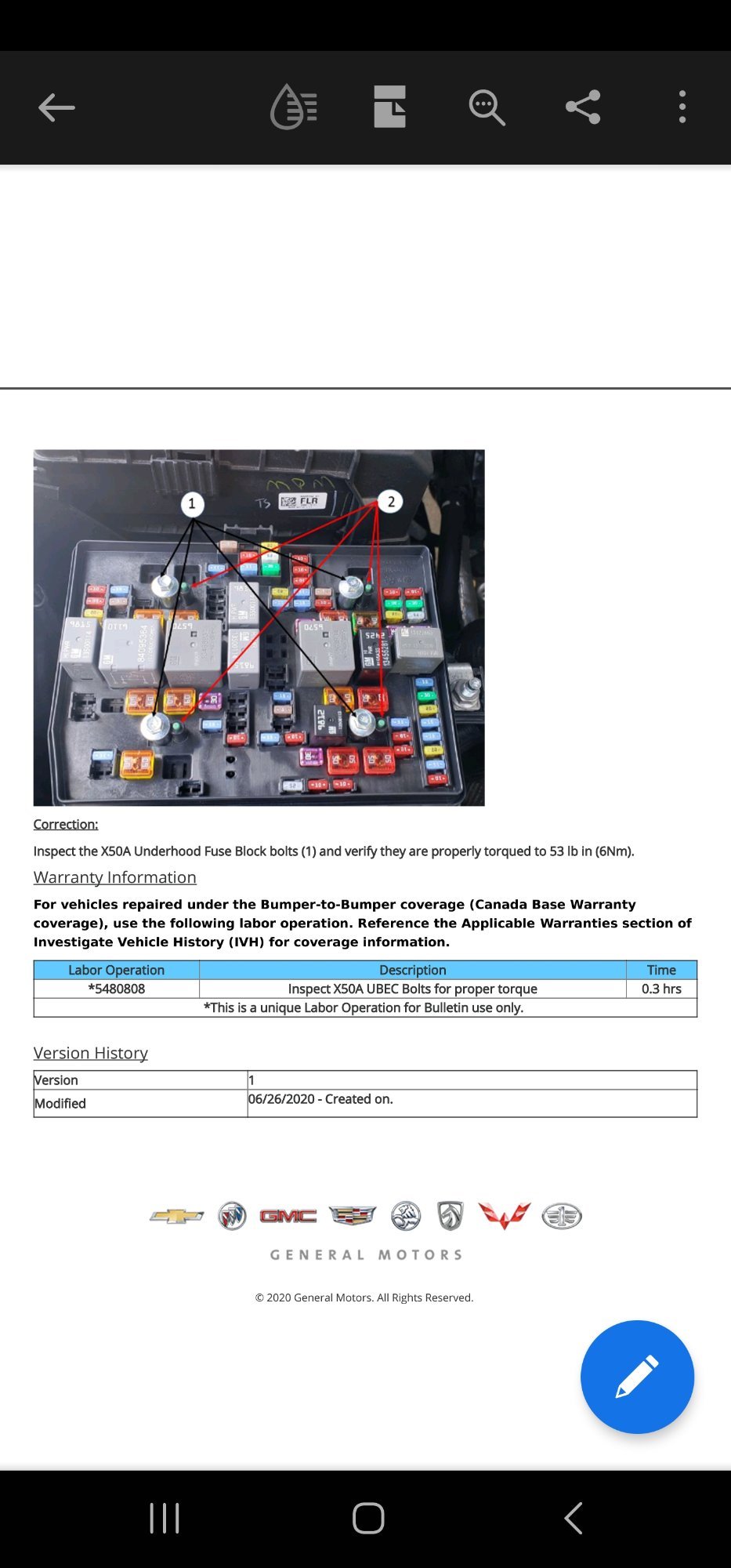

Has this been checked?...
Screenshot_20231116_154500_AdobeAcrobat.thumb.jpg.79cc4bfb371dc7973fa13a31865ef09e.jpg
My '21 had 600 miles when I checked the torque and all 4 loose.
Underhood fuse panel2.pdf
Ditto the fuse block bolts ... I had all kinds of weird stuff happening on mine including it dying on me while driving down the highway just to start up again on its own 20 seconds later ... happened multiple times.
I torqued down those fuse block bolts and problem went away ... worth a shot ... would do it yourself vs dealer ... .02
You were close!  It was actually a "loose" fuse terminal in that box, according to them.  Specifically the fuse in the starting/ECM cycle.  They replaced the entire unit and reprogrammed the ECM.
