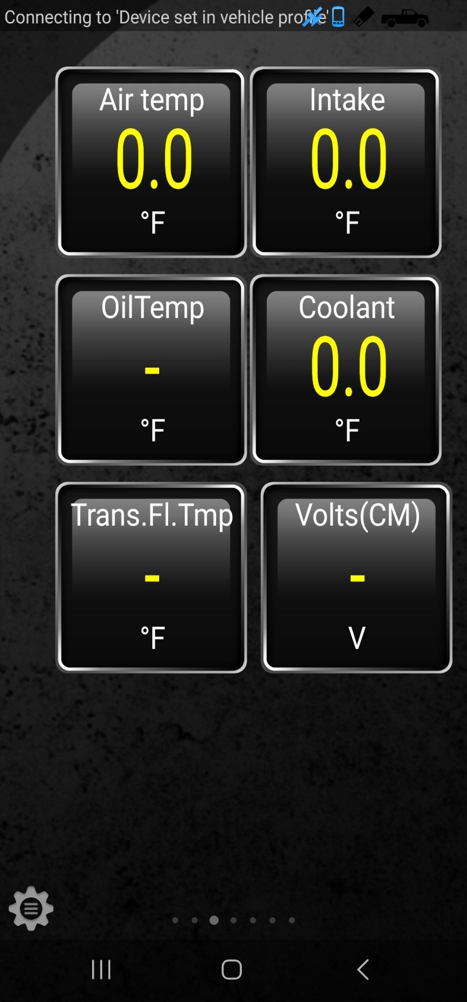

That seems like it should be a decent one. The one I have is a BAFX Bluetooth OBDII one. It lets me find out the codes, clear codes, and monitor various things. I have to use Torque Pro on my phone to see the data. But it is very customizable and can monitor all kinds of functions on same screen. Here is the one I use mostly when towing to see the various temps.
It comes in handy. I have a splitter cable plugged into the OBD port so I can have this reader running as well as my Range AFM disabler.
