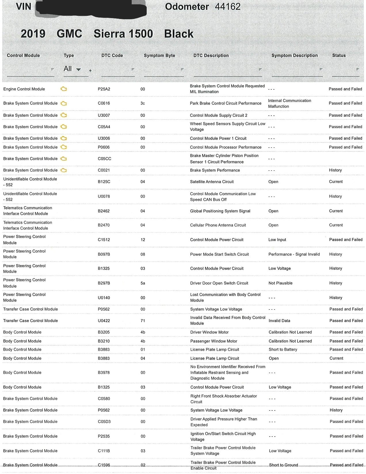

Do you have a list of trouble codes from the truck?  All those messages, gotta be some codes in there.
I will confirm this info when I get the truck back. The shop is a well known good local shop that specializes in truck suspension and modifications. When they did the inspection they said it appeared that everything was connected and installed properly.  I asked the dealer if they could send me the trouble code list.

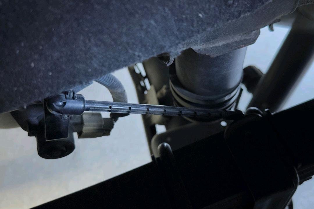

Got the truck back from the dealer, they said the lift is what's causing the spongey suspension throwing the system out of wack. No check engine lights or warnings are showing now. I got the truck back at the suspension shop and they found a broken suspension ride height rod broken. Surprised the dealer didn't catch it, they just want me to remove the lift. The shop did a temporary fix but still riding really spongey.
Here are other pictures of the suspension.
https://photos.app.goo.gl/MUFPJeUoJ6ngaH5Y8
The shop said they could replace and put fox shocks and coils which would take care of the problem. They said maybe the ECU isn't detecting the adaptive ride control?
