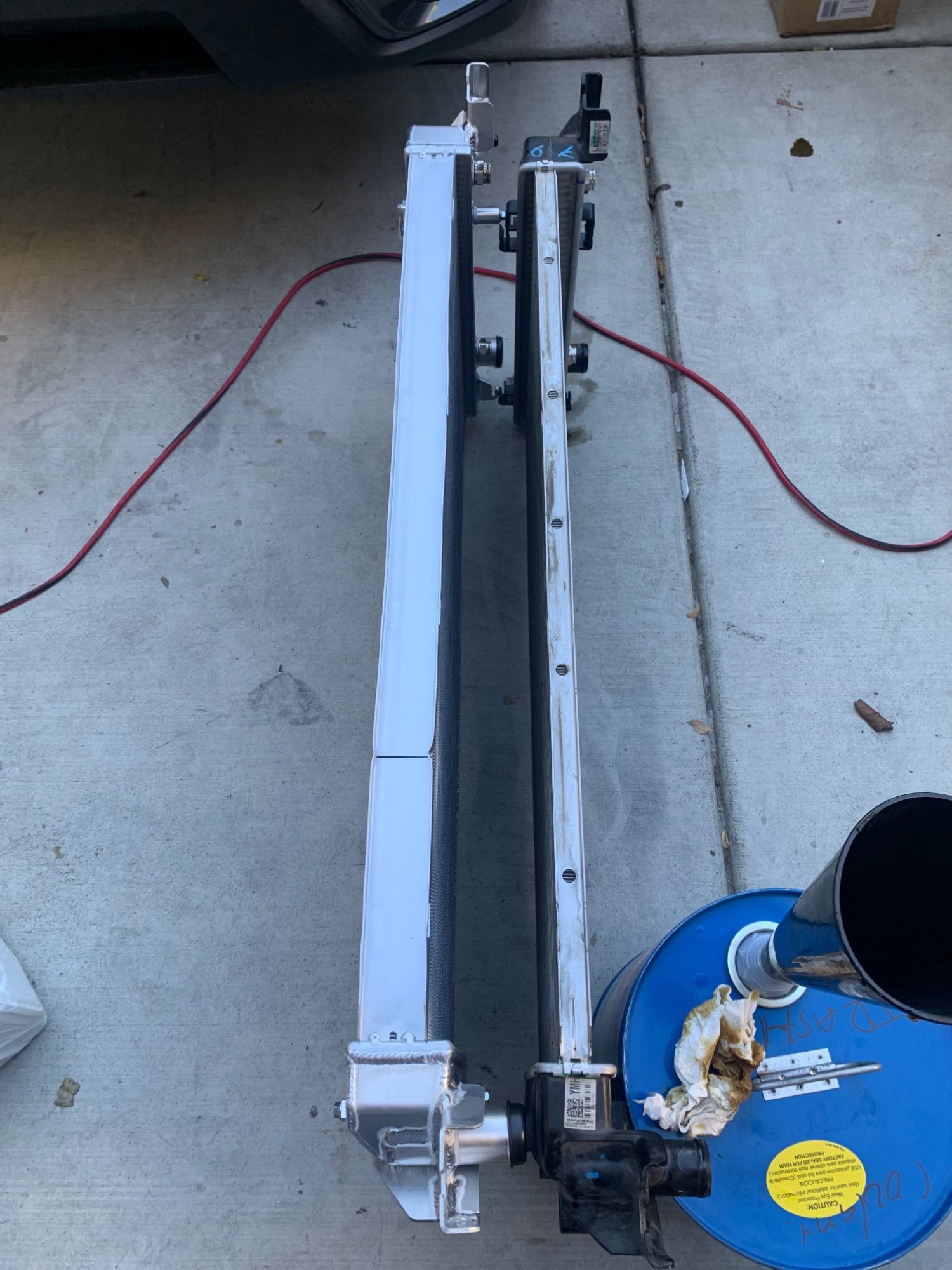

I’m running a Mishimoto radiator and Katech Tstat. I love it. No more overheating in 110+ day + towing up the hills. It is a lil bit thicker than the factory one just a heads up. image.thumb.jpeg.46142423ed4018d11cf56438edfeeacf.jpeg
Is it plug and play? Or do mounts need modification and so on?
