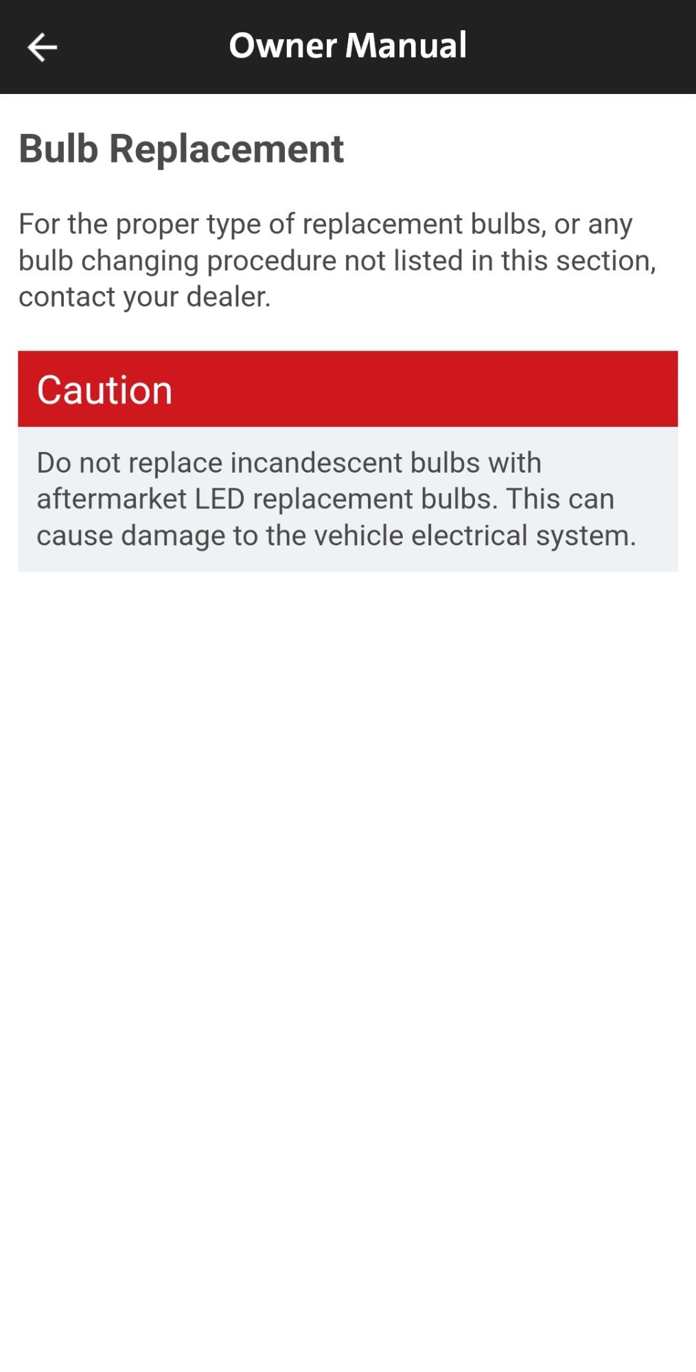

Just picked up a 24 Silverado WT with the offroad package and of course it came with standard halogen bulbs.  Previously had a 21 that I upgraded to LED without issue.  Strangely enough, when I looked in the owners manual on the app, it has a disclaimer that Halogen bulbs should not be replaced with LED bulbs as serious electrical issues may result.  I never had any kind of issue on my previous truck.  Is anyone aware of any issues that have been brought forward by doing the seemingly simple upgrade?

This is what the online owners manual shows.   I know I didn't have any issues at all in my last truck and the light output was amazing.   I had gone with the sealight off of Amazon and actually removed them before trading the truck in.   Screenshot_20240405_193330.thumb.jpg.6092d36f67a69b5b1492e274520ee507.jpg
the only electrical problems I can see would be the bulb out system that tells you if you burned a light without you noticing it and the pulse width modulated daytime running lights. In daytime running mode the lights are actually a modified sine-wave and on normal power they run at the full 12v power.
