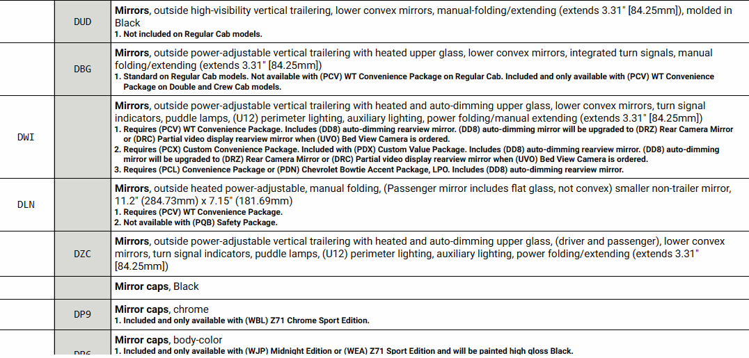

For 2024 and 2025 model 2500 models, the small mirrors are specifically called out as 'flat, not convex', on the passenger side.
Trailering mirrors are still flat on top, convex on bottom.
2024 2500 shows:
Maybe try an auto glass shop? I suspect they would have access to a bunch of vendors’ aftermarket replacement mirrors.
