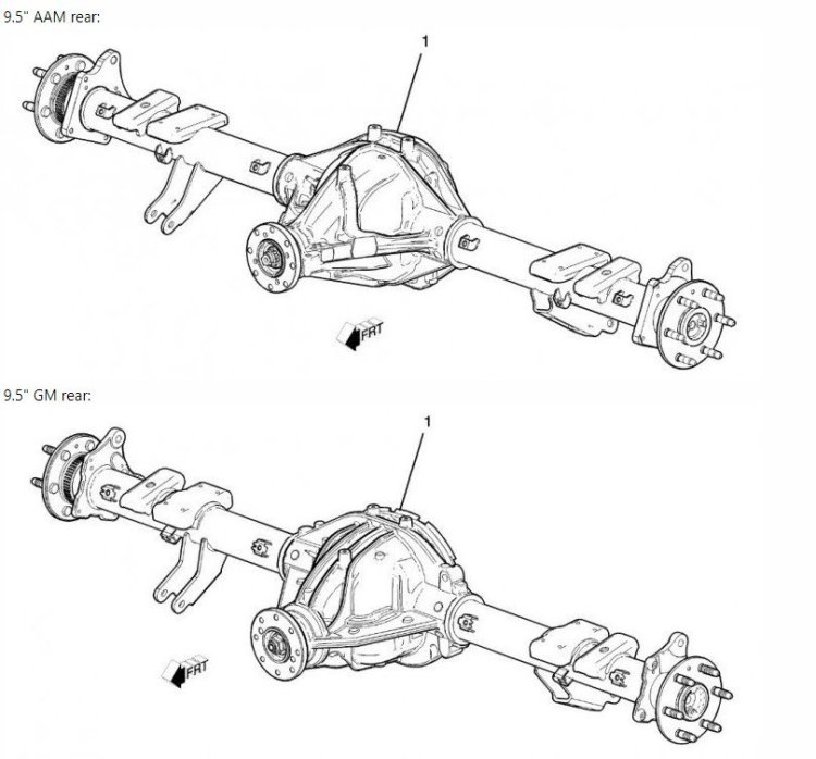

9.5" or 9.76" axle on the 2.7, 3.0, 5.3 and 6.2 engines.  The 4.3 was the only engine on this gen that uses the 8.625".  That engine is gone from pickups, so is the 8.625".
