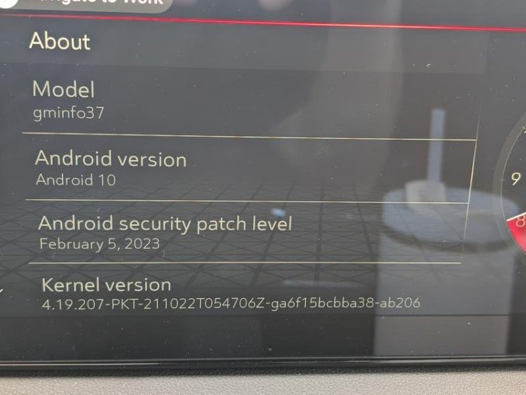

I had the update installed last week but have yet to experience the crackling.
I’m still running Android 10. I’ve tried to update but keep getting the message that.    I have the latest version.

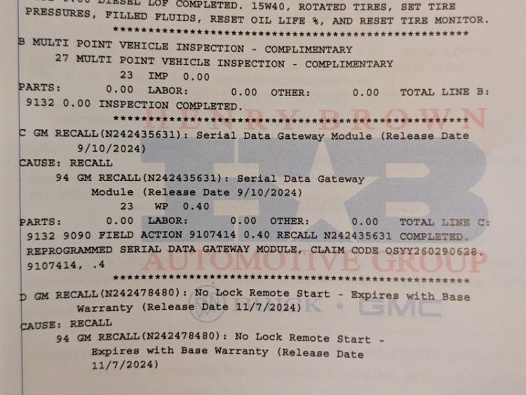

I believe they revised the serial data module recall to no longer update the head unit (separate from the serial data module) to Android 12 somewhere along the way, probably due at least in part to this issue.

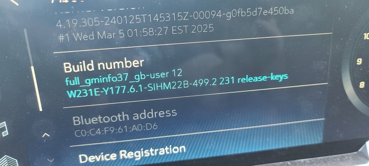

I recently had the update done while in for State Inspection.  The update did fix the crackling problem on Bluetooth calls.

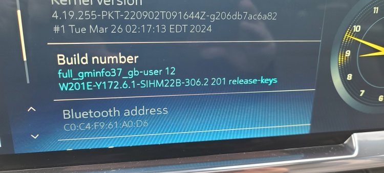

Now that Y175 is out they shouldn't be updating to Y172 (the build causing the issues) any longer. Just ask them to make sure they update to Y175 when you take it in for the recall.
I picked up my 2025 yesterday.  I ordered it october.  The first call i recieved on my drive home had this crackling sound.  Did i some how get the old software version in the length of time it took for them to complete my build and ship the truck to me?

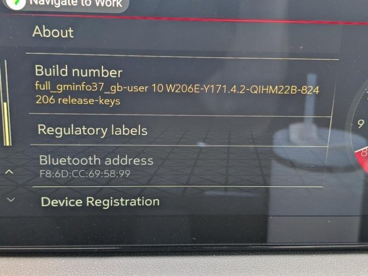

Very possible. Go to the settings on your head unit/infotainment, then System -> About, then scroll down to where it says "Build Number". The second line under build number will have some letters/numbers, then will say "Y###.#.#", with the pound signs being your current build. Mine is on Y172.6.1, which is what they updated to that caused the crackling. If you're on Y175.x.x it shouldn't have the crackling.

My warranty expired (2022 Yukon) between the initial recall update and the fixed version being released. The dealer says the update will cost $150 even though the issue was caused by GM in the first place. Can I truly not get this update myself?
