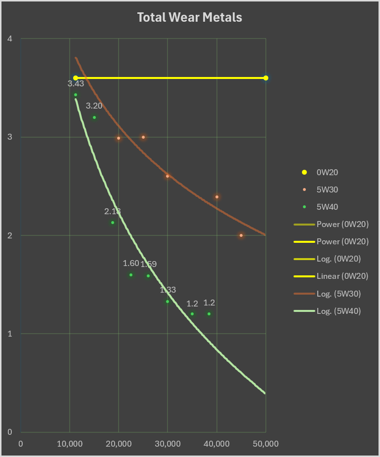

Linear? No, you are correct. Not linear but it is measurable.
Here is my latest project. The yellow line is the entire Blackstone Historical Universe for this motor platform on the OEM recommended 0W20 oil. Results fall well below the Industry standard (after break-in) of no more than 5 ppm total wear metals. Thus one could reasonably expect this motor to last quite some time on this weight and evidently most do.
One the web site for this platform enthusiast holding on to that warranty report making 200-300K miles but with a good deal of engine issues, heavy oil consumption (by as early as 80K), multiple timing chains and noisy valve gear. So yes, 0W20 will get you there and then to the bone yard. Longest one lasted 400K miles and was on display at White Bear Mitsubishi.
The Orange line is a fellow enthusiast, one I am familiar with, experiment into the heavier grade lubricant of 5W30. He's a Mobil 1 fan changing oil at 5K miles. He's passed 200K with the same timing chain, fairly quite valve train and light use of oil. Something like a cup between OCI's. His compression test are within 2 psi of new. Note lower total wear metals v the 0W20. There is a second fellow on that site with a bit less documentation that just did 300K on 5W30 in this platform that just published his compression tests at 5-8 psi under new. I think there is  good argument there that at minimum bore and piston skirt wear is nicely abated by this heavier choice. He still 50 psi above the factory minimum and very in balance hole to hole.
Light green in Raven, my unit. 5W40. Jury is out on how long it will last as it just passed 50K in under two years. However wear metals are once again vastly reduced. It uses no oil yet and the mechanical valve train is amazingly quite and it runs exceptionally cool.
I would be hard pressed to believe that such a drastic reduction in measured metals does not equate long term to a longer lasting motor.
I only offered the examples I have DATA for and people I actually know and trust. So once again, I'm not telling anyone what I THINK happens. I providing the RESULTS and the context. My batting average would have most testing me for performance enhancing chemicals...wait!...I am!
Now I've ran every Honda with 5W20 but again a high polarity oil with an exceptional HTHS value. High enough to exceed the SAE 30 minimum.
I just ran across an 5W30 with a HTHS value of a SAE 40. And there in Atlas lies the key. It isn't the SAE grade but the actual HTHS values and shear stability index results.
Looking for other outliers we could include those oils so light as to not support Stribeck but work due to enhanced AW chemistries. If you lean on these then the OCI needs to be short enough to not deplete their effectiveness.
The Toyota Crown calls for a 0W8 but as it is not yet sold here in any volume Toyota has cleared weights as high as 0W20 for warranty enforcement. A testament to the absurdity of 'heavy oils damage motors'. :bs:
Yes there are a few weird Spray Bore motors that don't like heavier oils due more to the hone finish. Special cases so no blanket statement will stand.

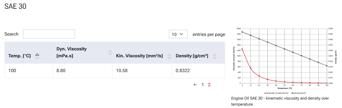

Stribeck says that we need a certain amount of viscosity under conditions of load and velocity to prevent two surfaces of a know roughness from tearing each other asunder. And we have marketing trying to tell the masses that those two surfaced require less of that commodity due to more exact limits being placed on the same old clearances. We also know that there are limits to how hard something can be before it becomes to brittle to be viable and to smooth to 'wet' the surface and that both of those conditions have been known and met since about the Second World War.
That viscosity value worked out at 10 centistokes at 212 F just under a hundred years ago.  Give this a look: [Anton Parr]
What is advertised is the Kinematic viscosity (mm2/s) or that which has been density adjusted but the value we are after is the dynamic viscosity (mPa.s) or true viscosity. You can see that this number is dependent on density thus base stock and temperature. You can also see that an SAE 30 doesn't reach that value in this example. However an SAE 30 that is at the upper end of the SAE 30 range; 12.5 cSt (mm2/s), might. 12.5 * .83 = 10.375 (mm2/s). If you could find an SAE 30 at the upper end these days.
Then there is the complication of viscosity modifiers or VII or VM, whatever you wish to call them. Polymers added to very thin base oils, perhaps 3 to 6 cP oils, that will meet the SAE *W30 spec at 'tested' shear rates and 100 C/212F  target temperature. So a polymer fortified base that is a fraction of the 10 cP requirement Stribeck insist upon.
This could be all well and good if those polymers didn't have two very problematic 'features'. They shear or loose viscosity both 1.) permanently and 2.) temporality. And they do both omitted in the advertised data with the distinct  purpose of deceiving the consumer of the actual operating state of the fluid. I've shown the example of Warren Oils COSTCO 10.91 cSt 5W30 formuation several times where the 100 C HTHS value is 6.9 cP!! That's the temporary shear down and with and SSI or shear stability index of 9.4 cSt. Note the intentional deception in using mixed units?
After a short while that 9.4 cSt oil has a viscosity corrected dynamic value of 7.8 cP. But as the SSI is still within the range of an SAE *W30 whose lower value is 9.3 cSt.
This allows them to continue to call this SAE 16 weight oil a 30 weight, the cake, and still meet the API requirements for fuel efficiency IMPROVEMENT mandated by the EPA. The eating of the cake. By the time you've worn out your motor doing the responsible thing by adhering to the warranty requirements, (the stick), you get deprived of the carrot, wear control. So sad, to bad.
So what can be done? Do I need actually say? [Anton Parr]
Even this must be monitored if the oil is on the low side and the VII an organic or you opt for a 0W40 with an even lighter base oil and more / higher MW VII. (Note the lower density of the 40 weight versus the SAE 30 mono-weight?)
There is another workaround. Temperature. An SAE *W30 run at a bulk temperature of between 180 and 195 F.
Being the belt and suspenders sort I am I do both. Run it cool and run it heavy.
