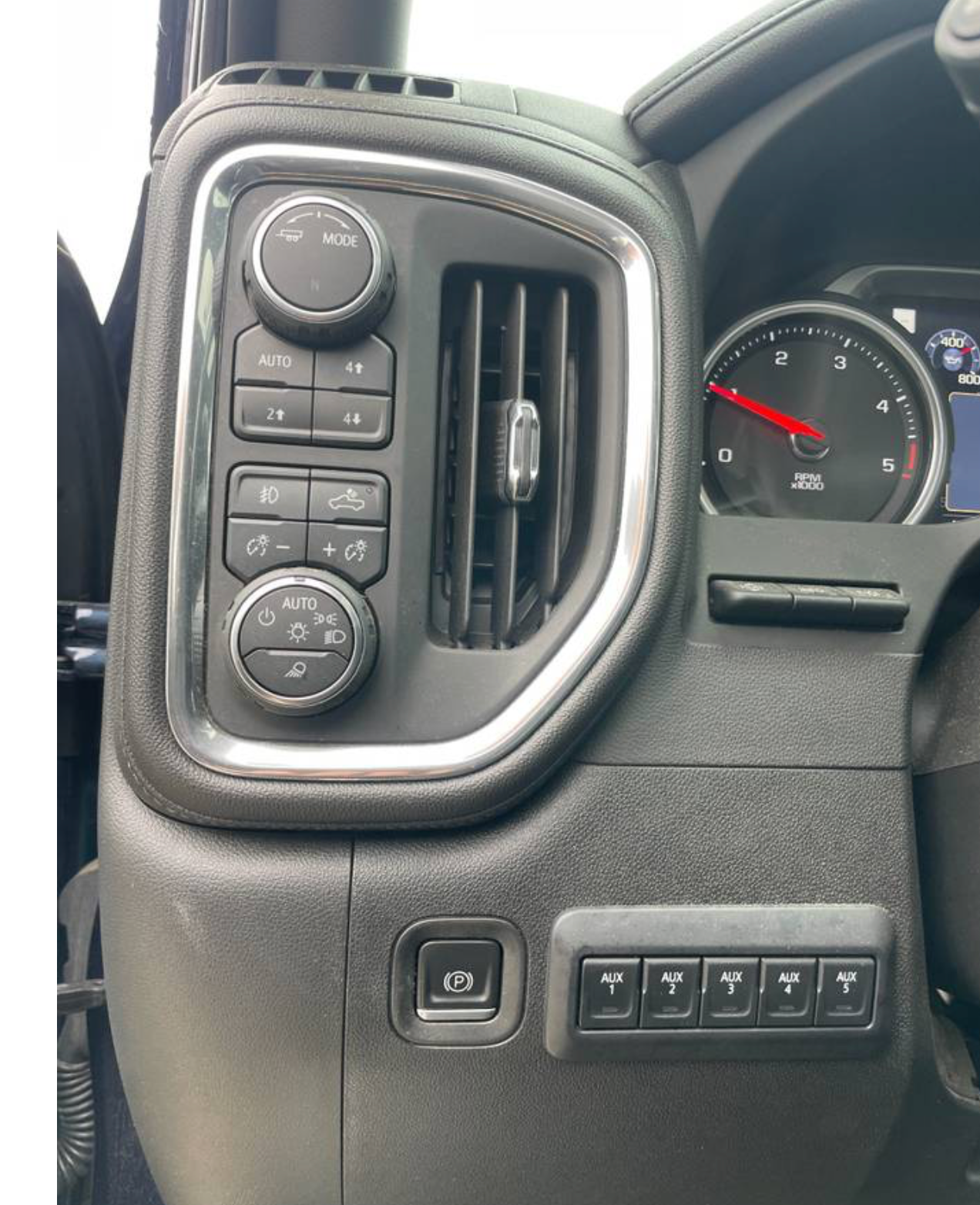

I've looked through the owner's manual and I think you're correct. It being the upfitter. I have 5 aux switches on the left side of the lower panel driver side that don't do anything. I found a youtube video where the guy has a similar harness.
Thank you, upfitter was the word I needed.

Aux upfitter switch wiring.  HDs have the switch in the dash already, just needs to be wired up.

I have the all the kit parts as well. The install part that takes the longest is the bank of buttons on the interior kick panel. You need to take the entire dash apart to install those or cut a hole if you are feeling lucky.
I had to go back to the dealer and get the fuses and screws to complete the kit. Fortunately, I have the switches already installed.
There are few threads on this forum that go into details on how to install it. The dealer might but it seems that they don't really want to?
I have a couple of accessories that I am going to install as a start. I am also going to run the 4 hot wires out and into the engine bay so I can attach to them for lighting etc... The 5th one will be a tap for my dash cam.

HDs come with the switch bank and dash panel for the switches pre-installed.  The rest of the kit just has to be installed.
Here's the instructions from GM - UI-Bulletin-153e.pdf
The instructions for enabling power to the aux kit and if adding a snowplow, power for that - UI-Bulletin_147b-Snow-Plow-power-provisions.pdf
