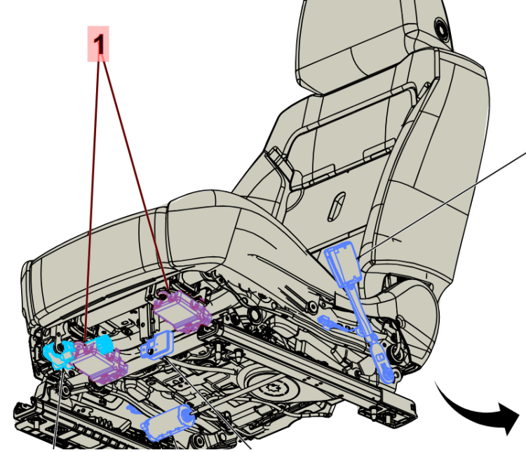

Module is under left front seat near the front. 2 connectors

I see a 2 connector module on passenger side  and maybe 5 connector module under drive side. From what I have found is the one under the passenger seat is a heat module but is that for just passenger seat? Driver seat looks to be for seat memory which is not working either. I can set a position but won’t return to it. Would this module on driver side include both memory and heat?

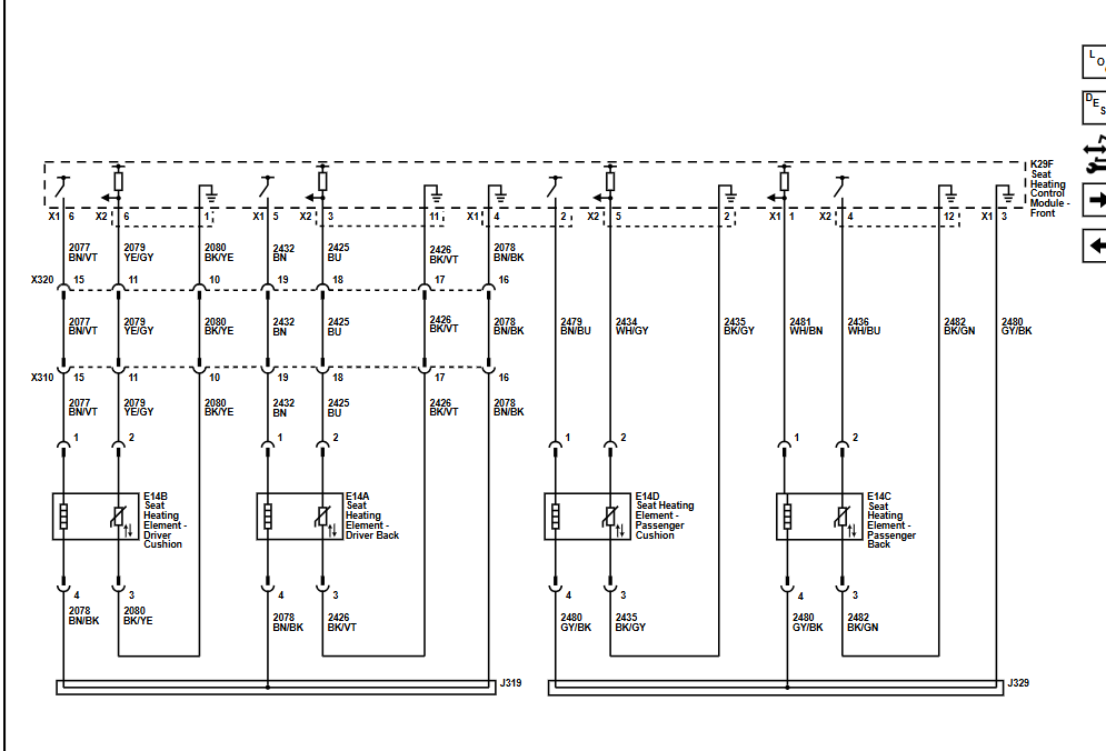

Do you know where I could get a wiring schematic for these trucks? My fuse is reading 14v on both sides

Upon further review, heated/ventilated seat module is under RF seat. It shows 2 modules. Don't know why. Should have 2 connectors, 1 - 10 pin and 1 - 16 pin.
