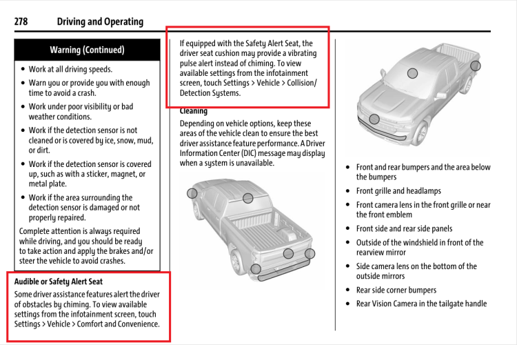

The alert, be it the beep or the seat should go off for parking assist, rear cross traffic alert, forward collision alert, trailer jacknife, some adaptive cruise alerts (if you have ACC) and Super Cruise (if equipped).
The owners manual - 2025 Chevrolet Silverado 1500 Owner Manual

I looked in that area of the settings, my truck has nothing about the seat.
Hmm.  What trim level is the truck?
Rst.  I was at the dealer today because they had to install the large Chevrolet decal on the tailgate and they checked my vin and it definitely has the safety alert seat. I am just looking in the truck. The owners manual says in the “comfort and convenience section” only has chime volume option. Under the “collision/detection” section all settings are either on or set to alert and brake.

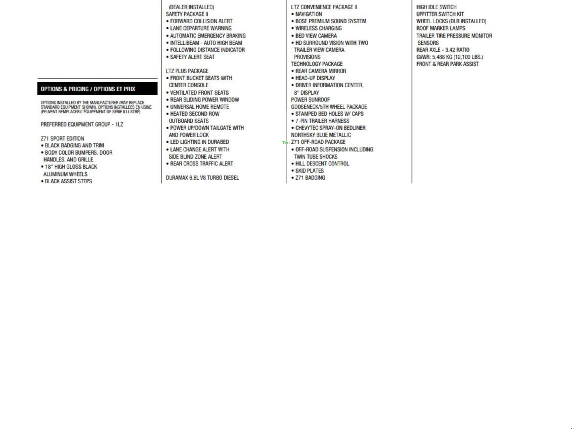

Looking at the order guide for 2024, 2025 and 2026, option code HS1 Safety Alert Seat is not available nor included in the safety package on WT, Custom, Custom TB, LT, RST and LT Trail Boss.
It is only available and is actually standard on ZR2, LTZ and High Country.
So it seems you don't actually have the safety alert seat, and it sounds like someone isn't reading something correctly on the build for your truck at the dealership.
Vehicle Order Guide
The GM literature online when you “build and price” my truck shows the rst comes with the safety seat. I forget the exact option code the service manager told me it was but I believe it started with a “B”. Like I said, he told me according to my trucks build sheet it has the safety seat.
Fleet order guide shows
Shows as only standard and only available on ZR2, LTZ and HC
Note 1 applies to LTZ only.
Found out what rpo code they were talking about.
Ask them if it has HS1.
They can print you a build Sheed. It will show more rpo codes that what are shown on the QR code on the trucks doorpost.

My build sheet shows it as "Safety Alert Seat" in Safety Package II as a dealer installed option:
