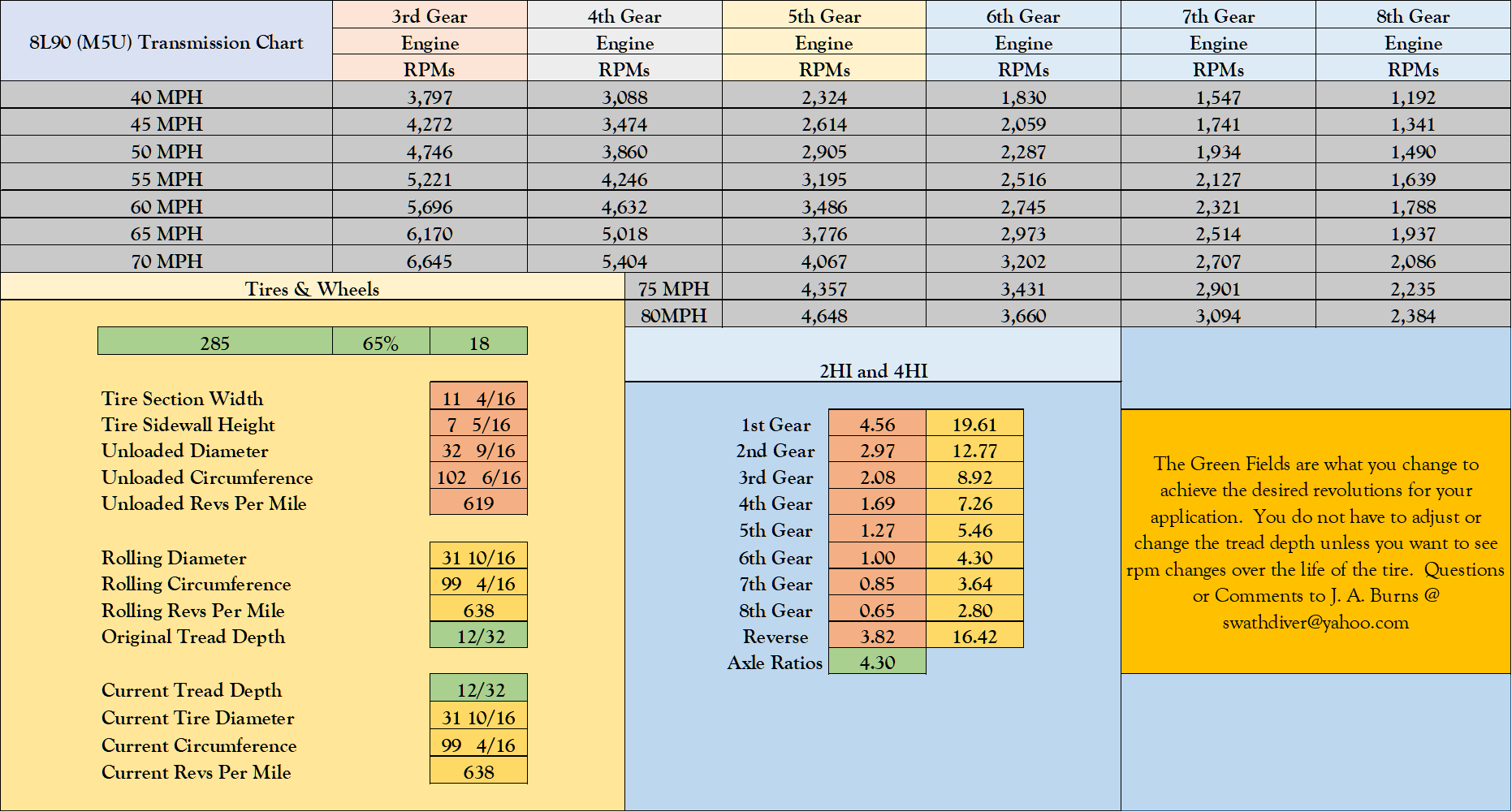

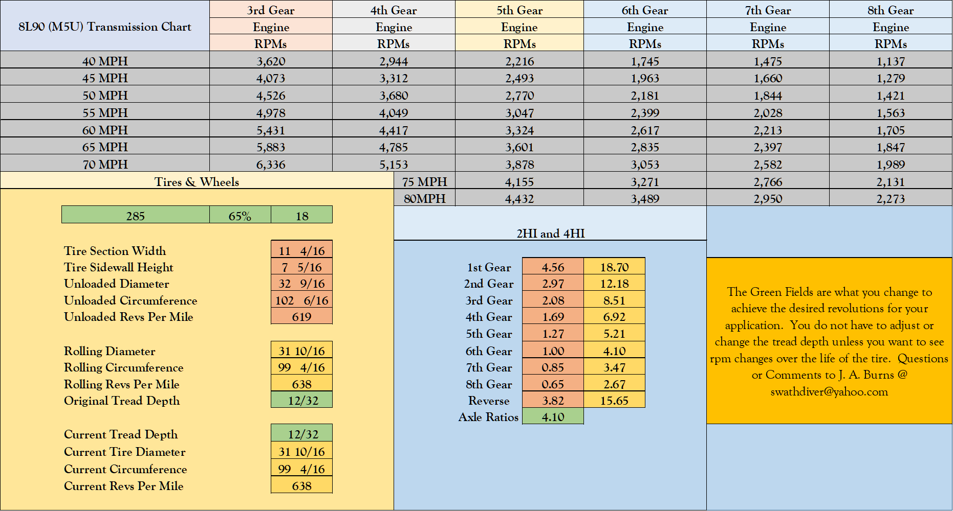

Here are your effective ratios and rpms at speed as configured now:
3.42s:
3.73s:
4.10s:
4.30s:
https://demandaam.com/expview/976-RearAxle-Salisbury-12Bolt
