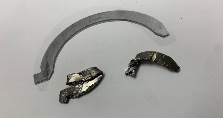

We had one fail prior to the TSB coming out.  Had about 5500mi on it.  Happened in July this year.  It ran and had no noise but had the P06DD set and low oil pressure.  Tech pulled the oil pan and it was grey anti-sieze colored engine oil all over the place, and the thrust bearing sides were ejected into the pan.
I don't have a picture of the oil and oil pan, but here's the pieces of the thrust bearing side and what it's supposed to look like.  For whatever reason on the LM2 and LZ0 Duramax, and L3B Turbomax, the thrust bearing is a three piece unit.  So there is the upper bearing shell and then another p/n for the thrust sides of it.  On the V8s though, the thrust looks the same but the sides of it are clipped to the bearing and not just loose installed next to the bearing separately.
I won't be shocked if more show up across the US, even if its a small number of failures.  There's been a few in the GM Technician Facebook group already.
