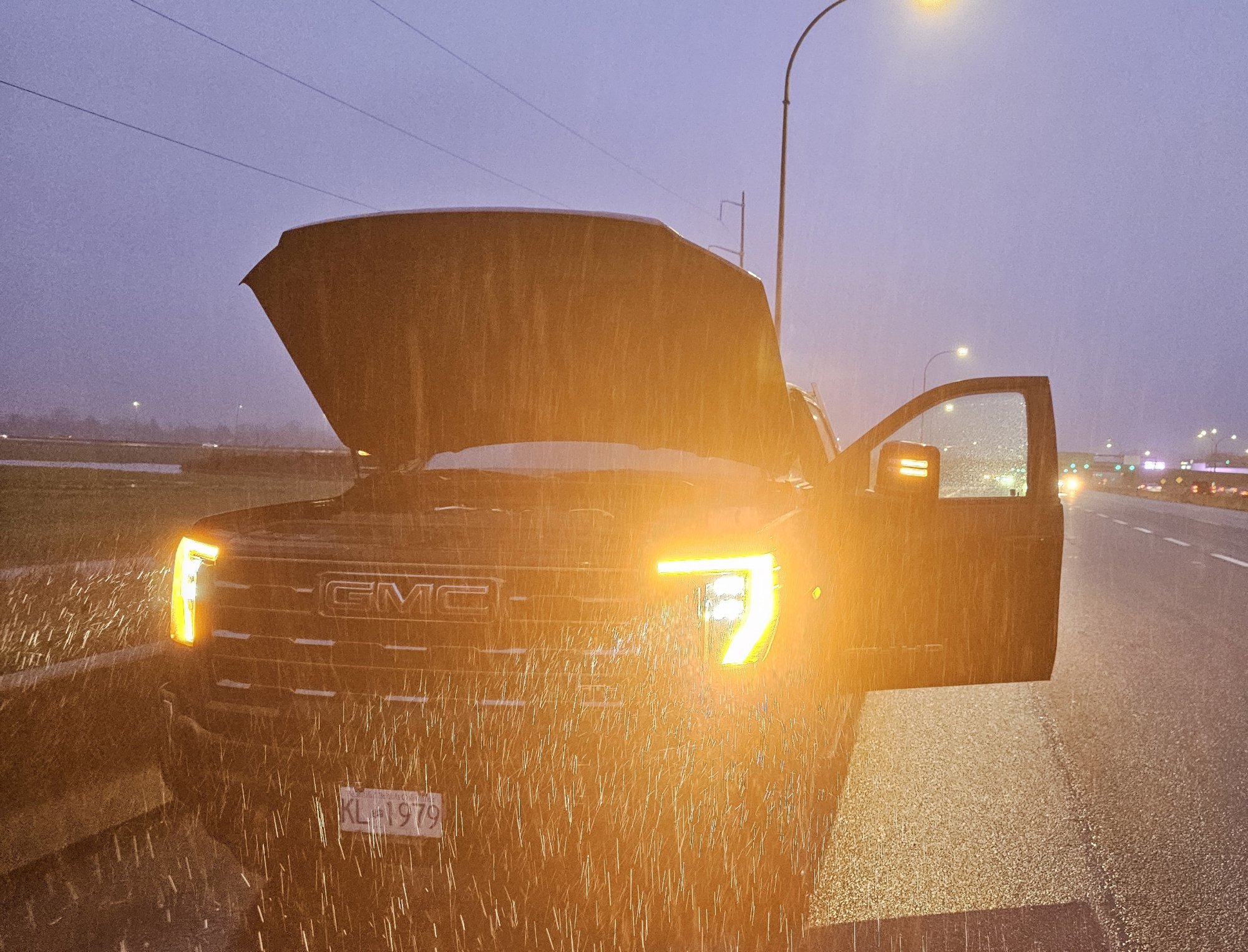

Well here's another one. Driving down the highway when the truck suddenly loses power. Takes me a sec to realize the truck isn't running. DIC warning 'put shifter in neutral and press start button'. Nothing happens. Manage to strongarm and stop this beast in the center of the highway (middle turn lane so somewhat safe). Put the truck in park and tried the ignition. Engine turns over but will not start. Phone gets the text below. I really do want to love this truck, but I think I got a lemon. Three times prior speed restricted with the last fix a replacement throttle body. And now this. Towed to the dealer (though out of range so I am on the hook for the extra distance not covered by the warranty). Funny that the first truck couldn't take it as the electric park brake engaged as soon as he put it in neutral. Had to call a flat deck. Or so he told me- I took an Uber home long before. Anyways, thought I'd share another fun experience that I have had with my truck.

So got the truck back today. The cause was a battery internal circuit fault. They jumped the vehicle, found a bad battery and replaced it. Did not speak to the tech, only the service tech
Now, don't know if I buy this. The truck has dual batteries. If it has enough power to crank over, why not enough to run all the related electric circuits.  SO I guess you all should be aware that if your battery is failing you won't get a warning other than the engine shutting off. While driving. At potentially high speeds. Thought about going another route and getting rid of this pig, but after spending Friday night researching other trucks, it seems that really no one manufacturer is better than the other- they all put out garbage at times. It's the devil you know I guess, as my Grandma used to say.

Did they not suggest to replace both batteries? I wonder if the second battery dropped (as low as the main battery) low enough to prevent the electronics from working?
Cranking over the Duramax probably takes a ton of amperage and this could pull the voltage down enough for the electronics to stop working but this happened while you were driving which is puzzling??

Are diesels not like gas where they will run indefinitely on a bad battery as long as the engine is running? If so, I don’t buy a bad battery causing the vehicle to shut off going down the road.

I agree with you that I doubt the problem has been fixed. When it died and I was parked in the center of the highway, I noted that the dash etc stayed on. Even with the truck 'off' I still had radio and display. Opening and closing the door made no difference- display was still on. I think that is what killed the battery. I told the service guy but here we are.

way back, with fully mechanical diesel setups, I would say this is true (depending on how the fuel shutoff setup was designed), but more modern diesels have a bunch of electronics controlling them, both how the fuel injection side works, as well as the regeneration side, so if the electric power goes south, the engine will stop working.
Diesels are slightly less susceptible to this, as GM uses a 2 battery setup for them (I think even the 3.0 duramax gets 2), so a bad battery is less likely to take down the electrical system (it's still possible though).
But if the alternator is working ok, and the battery is just not holding a charge (vs say, having an internal short so it draws more power than the alternator can put out), both gas and diesel engines will just keep going.

Bad batteries can send electrical "noise" through the system. This causes problems especially in these new vehicles. There are MANY modules and they don`t like the noise. No electronics do. AND, these modules are communicating back and forth with each other at all times. Many problems pop up with bad data.

So here we go again. Died again, this time doing 90 on a freeway onramp. Oh joy. Another tow back to the dealer. Finally talked to the service manager. That made me happy as I was also able to show the video of the truck blowing blue under hard acceleration. Anyways, he explained why they replaced the battery which obviously did not help. They replaced a 'fuel pump module' and will do further testing. After looking around online, it seems that every manufacturer puts out turds at times- mines just one of them. So I may as well stay with GM. Likely will take a kick in the nuts and trade this one in for a 2026. Cheers everyone.
