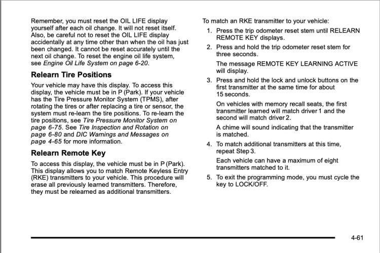

Below is a video that explains the process without DIC buttons. Is this the same cluster you have?
Doors must be closed and vehicle must be in "on" key position (as far forward as key will go without starting truck) in order to access the relearn option by pressing the trip odometer reset stem.
Here is the page describing the process from the 2010 GMC Owner's manual (available for download) here:
https://www.gmc.com/support/vehicle/manuals-guides?ppc&gad_source=1&gad_campaignid=14854917496&gbraid=0AAAAAoJEXtb5PnKhuhgWlhAet3isxa8xe&gclid=Cj0KCQiAqeDMBhDcARIsAJEbU9Rz6vdQI67CsV2BWR_FpETiNUFTUJTaCxJZ3PugyANmkyVEWDERWj0aAk7mEALw_wcB
Starting on page 4-58 for displays without DIC buttons, relearn sequence on page 4-61:
Seems pretty straightforward...if the menu option isn't available, it's likely the truck was never equipped with keyless entry. Is there an aftermarket alarm installed in the truck that could be causing it to go berserk when you open the door?
