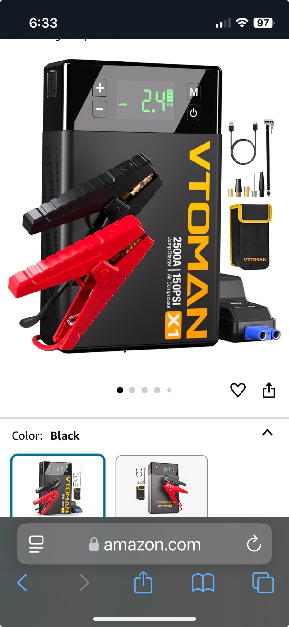

There are no signs and no fixed time. My wife’s 2011 Genesis had two. The first one lasted 4 years the second one installed at the dealership is still going. The driving loop is the same. I have many examples similar to that. So I carry a jump box and inflater with me. The 80$ device is cheaper than replacing a good battery.
