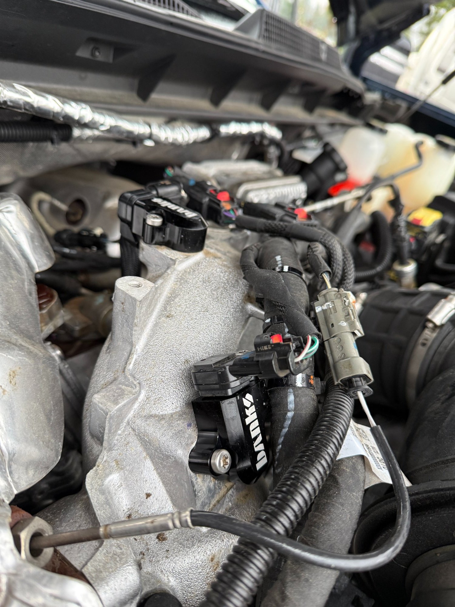

Been doing some maintenence (oil, fuel filter, etc) and decided to pull my MAP sensor.  Truck has 21,xxxkm (13k miles).  It was fairly plugged up.  Its simple to remove.  I popped the hood, waited an hour to make sure the truck was sleeping, popped the connector off, took out the 10mm bolt, cleaned the soot off with MAF sensor cleaner, let it dry for 30 minutes and reinstalled.  Will likely start doing this at every oil change.20260511_122605.thumb.jpg.ecd042170d683e4e4f5bd755186674a3.jpg

I cleaned both of my sensors and installed the banks sensor relocation kit:
The kit takes the sensors out of the soot stream.

I pulled mine last night at my latest oil change.
It has at least 90K mile on it since its seen daylight. It looked about like the photo above.
I knocked the loose stuff off, shot it with some cleaner, hit it with compressed air and put it back.
I'll be danged if the truck doesn't seem to be a little lighter on its feet today. With a bit better milage too.
Guess I'll be more regular about cleaning it.
